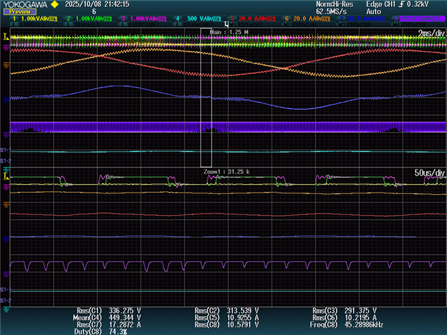

There're few questions here about the tested waveforms. The boost output DC bus works up to 435V, it's ok. But its input current as waveform with CH7(Blue color) is not likely as pure SINE wave. And the the PFC's gate driver is not switching to 0V when crossing to Zero switching period. It looks that there are difference between real on-board test and SIM result.  Could you offer the comment to improve it! Thanks.
Application: AC inverter Motor Drive
CH1 : U/GND
CH2 : V/GND
CH3 : W/GND
CH4 : P/N
CH5 : U Phase Iout
CH6 : V Phase Iout
CH7 : R Phase Iin

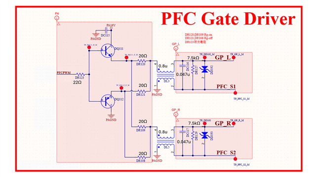

CH8 : PFC gate driver
Spec:
Vin=220V 60Hz,Iin=17A,Vo=300V,Io=10A
On-Board Test:

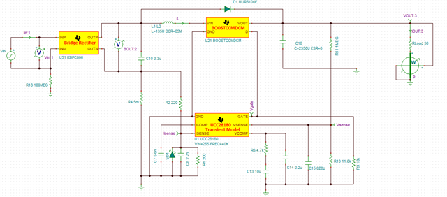

SIM result:

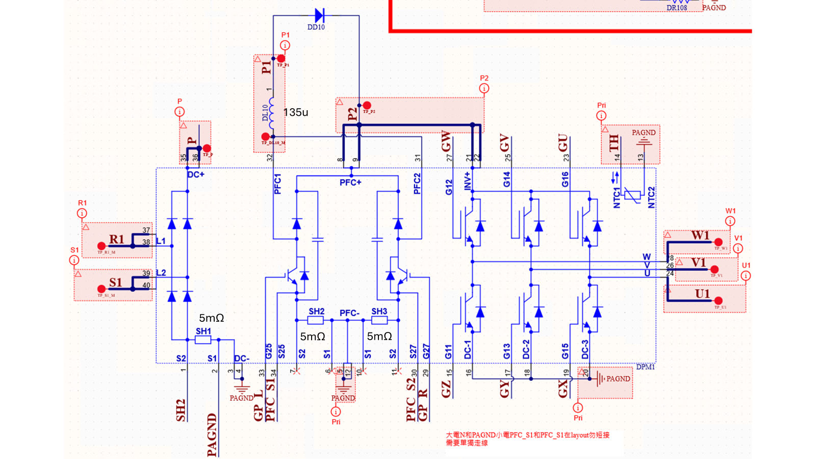

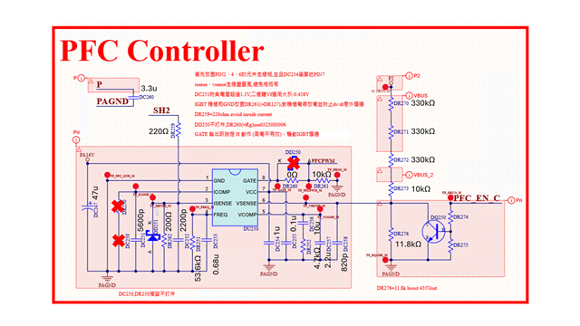

    Please see the attached files for the partial schematic and the design calculator.

    Following up on your point, I'd like to ask what a reasonable value for the Inductor Current Ripple Factor (LIripple_factor) would be? And, given that the inductor value based on the design calculator is 135μH, what value should I change it to in order to effectively reduce THD and solve the zero-crossing current distortion issue?
    Also, if I choose not to change the inductor, can I solve the problem by changing the CICOMP capacitor from its value of 5600pF to a lower value, or by adding a parallel RC network (DR250, DC250) to the current loop?

    Additionally, I tested changing the CICOMP capacitor value to 2700pF. This appeared to improve the distortion, but the resulting current waveform (CH2) is now triangular, which seems incorrect.
    CH1: Input Voltage
    CH2: Input Current
    CH3: PFC Vge
    CH4: W Phase Vout
    Thank  you.
  • Hi Chienhao,
    In the wave form that you have shared the inductor seems to work in DCM mode in the edges of the line voltage. The inductor has to work in CCM for the ic to work properly and get lower line current THD. Try to increase your switching frequency so that the inductor current ripple will reduce and more portion of the line current will work in CCM.
    Sanchayan
