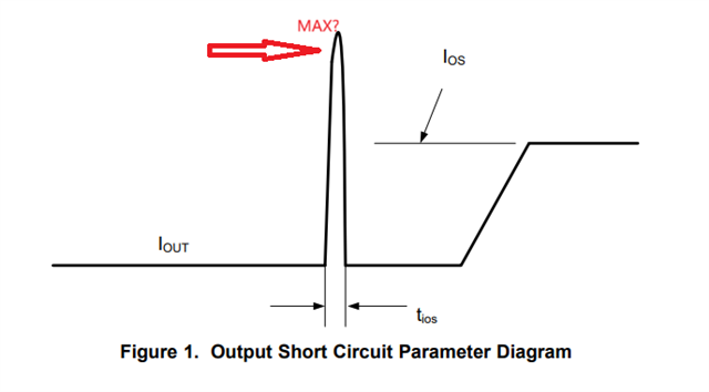

    Yes, The table shows the limited current point is 1.7A . The internal limitation is achieved by the integrated Mosfet?  What they want to understand is the Mosfet's limitation——SOA. the reason they want to get this is one of process is test the ABS value performance when customer qualify a new device in their AVL
  • Hi Ke
    BTW,  I think we can use the Isc for stress measurement during the steady states.
    But what's the maximum value that the device can withstand in this picture in short condition?  I think it is related with the Mos's capability.
    Is the internal Isc adjustable by external components?
  • Hi Harry,
    It's more about thermal. With a shorter tios usually you can get a higher I_peak tolerated. So there's no accurate answer for your question.
    Isc is not adjustable.
    Please also check "7.3.2 Current Capability Advertisement and VBUS Overload Protection", I may suggest using 1.67A rather than 1.7A.
