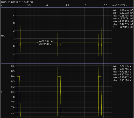

I have seen abnormal current consumption from the battery. I have designed BQ25672 with a ship fet and a single VBUS input.
When the battery and external power supply it is connected to the BQ25672, I see about 380uA current consumption from the battery.
Is that normal operation?

    There is a VBUS 12V, and the battery is in range from 7.5 to 8.2V. I have seen that this current draw has a constant value with no spike between the trickle charge periods.
    When the external power is disconnected, the BQ25672 correctly disables the ship FET, and the current drops to 17uA.
    For example, below is a plot of voltage and current drawn from the battery with VBUS 12V.
    Battery connected to BQ25672 through an FET, which protects the battery against charge (internal charge termination function), and the voltage on bat pins comes trough the body diode of FET.
    Circuit is same as in this question, with default configurations. e2e.ti.com/.../bq25672-bq25672-reregulation-vsys
    There is passed condition that VBUS>VBAT, but I still see current draw from the battery, and configuration like disabling ADC or something else does not affect this.I would like to increase as much as possible the recharging period for the battery, so this question is repeated.
    Serhii

  • Hi Serhii,
    Unfortunately, that battery discharge current is not unexpected while input voltage is attached.  After termination, if you want to prevent battery discharge current and more frequent recharges, you will need to add a PFET between BAT and battery pack.  The PFET can be turn off to disconnect the battery from the charger.
