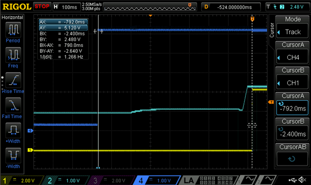

POT R5 to 0.
REGN rises 790ms after a valid 5V VBUS is inserted. Nothing happens 220ms before REGN rise. "After 220ms delay complete", 220ms after what ?

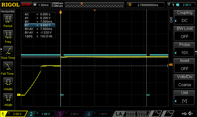

INT pulses when REGN has risen, and pulses again 7ms later. Which pulse is for the completion of the Input Source Type Detection ?
INT pulses AFTER REGN has risen, doesn't match what I read in 8.3.3.3 in datasheet.
Also, tried to write 1 in FORCE_INDET reg, and INT doesn't move, no pulse. D+ doesn't move either. How would I know that the D+/D- Detection has been completed ?
The charger is a BX-050300, probably not bc 1.2 compliant.
ch1: VREGN, ch2: INT, ch4: VBUS

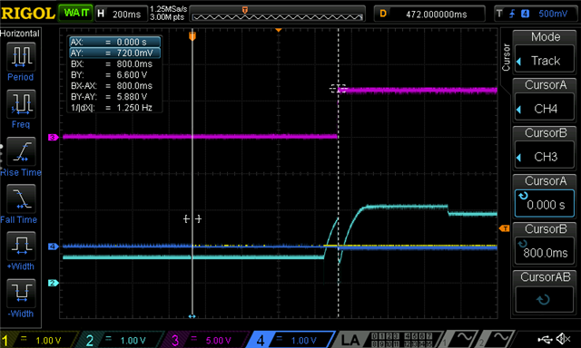

    I tried a 1.2BC complaint USB hub (UH700).
    I'm unable to confirm that the D/D detection has been performed.
    after insertion, I see D- rising but being abruptly discharged. Then a first INT occurs 3.12ms later.
    ch1: D+, ch2: INT, ch3: REGN, ch4: D-
    And it's 800ms later that REGN rises.
    I tried writing INPUT FORCE SOURCE DETECTION (WD disabled of course), and nothing happens, nothing on the D+/D-, nothing on INT.
    What I am missing ? Or do I have a damaged IC ?
    Olivier C
