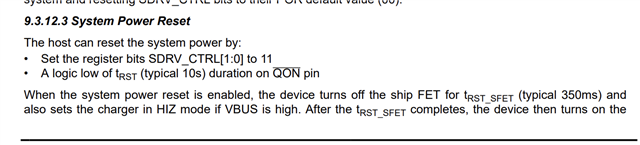

I work with the bq25798 and for secure I want to allow reset power system using SDRV_CONTROL = 11h like here
It doesn't work and I don't understand
First hypothesis : I haven't FET in the SDRV pin but I think that this command cut off BATFET for 350ms and it's enought
How can i make a good System power reset?
