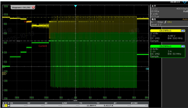

Hi team,
My customer BYD use TPS2HB35-Q1 and ILIM2 resistor is 14k, which means current limit is 3.8A. But in the real test, the current limit is 5A. Could you kindly help check it's normal? If it's abnormal, what we need to check? Thanks!
BR
Jiawei
