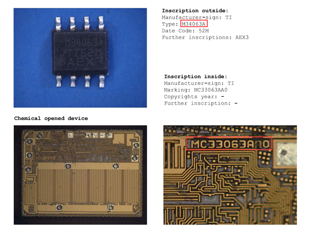

MC34063A: the wafer part number is different from marking number, is it possible that the factory made incorrect part number on marking?
Part Number: MC34063A
Other Parts Discussed in Thread: MC33063A
we purchased MC34063ADRG4 from local franchiser but the pcb did not go well.
we made decap solvent test and it passes ,but chemical decap test of MC34063ADRG4 did not pass.
The wafter part number is MC33063, instead of MC34063.
Is it possible that the mexico factory made incorrect part number on wrong part?
and what would make this suituation?
