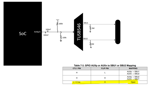

    The AUX interface is an AC coupled interface as seen here.
    In a USB Type-C DisplayPort alt. mode system, the AUX and SBU is MUXed as follows.
    Before a cable is connected to the USB Type-C receptacle, the AUX and SBU path is open. This means that the SBU1/2 nets will be pulled down to GND through the 2M PDOWN, the AXP signal will be pulled down to GND through the 100k PDOWN, and the AUXp signal will be pulled up to 3.3V through the 100k PUP.
    When a cable is plugged in the AUX DC voltages will level to the appropriate common mod voltages, but the AC caps will discharge/charge which results in this waveform.

    >This is most likely due to discharging/ recharging of the AC caps during plug and un-plug events
    If root cause of posted waveform is related above description , I wonder why DC shift does not occur on first packet.
    (As I show following figure, DC shift occur for second packet not first packet.)
    Can you explain about this ?

    In this case this may not be the charging or discharging of caps. Are you able to send the waveforms from before (AUX inputs) and after (SBU outputs) of the TUSB546?
