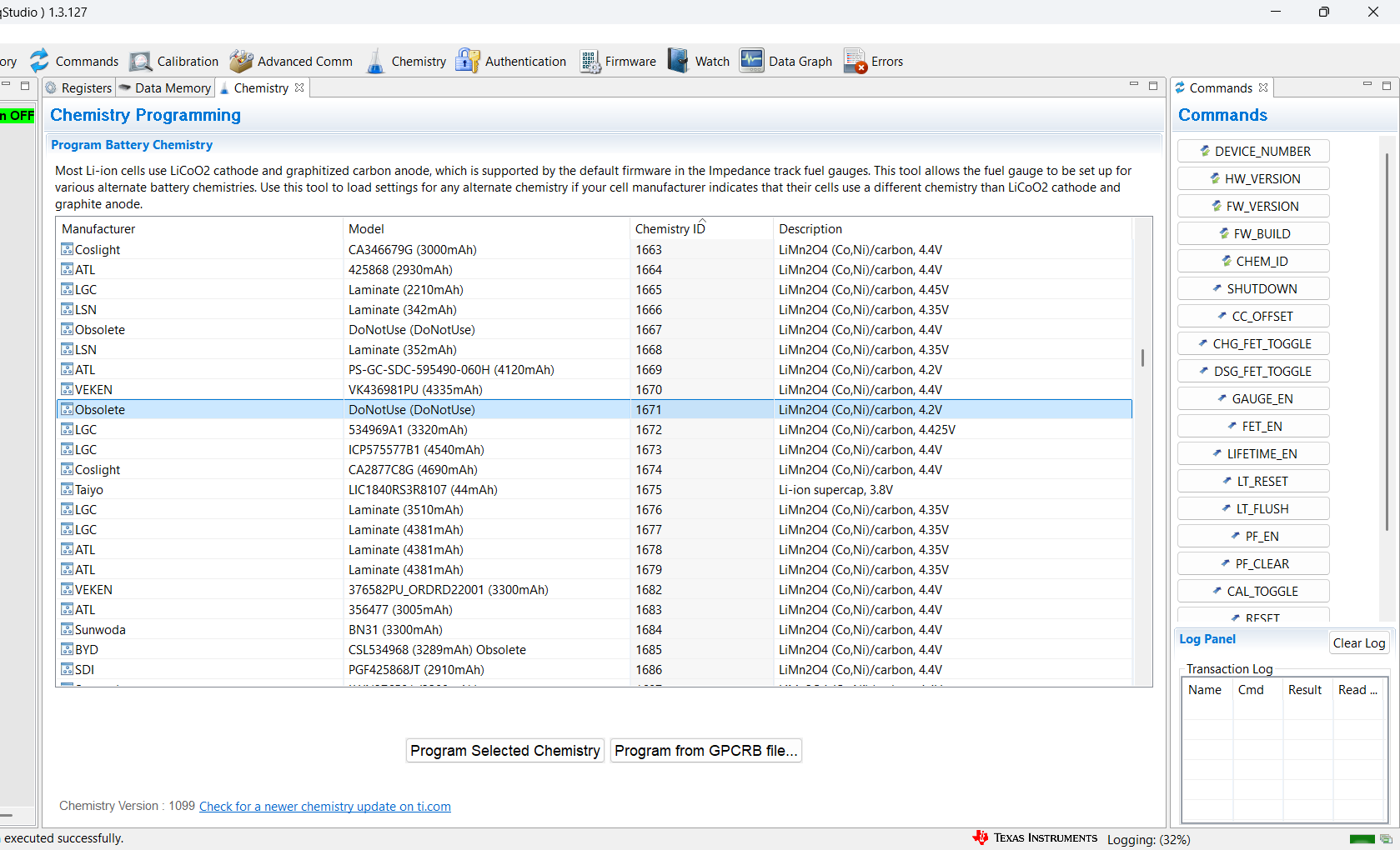

BQ28Z610-R1: GPCCHEM is giving wrong chemical ID
Part Number: BQ28Z610-R1
I followed the procedure outlined in TI Application Note SLVA725A to determine the battery chemistry ID. The process included the required sequence of charging → resting → discharging → resting.
After completing the test, I uploaded the resulting ZIP file to the GPCHEM tool and received a response email containing the matching chemistry ID. However, when I searched for this chemistry ID in BQStudio, the tool displayed a message stating that this model should “not be used” or is “not recommended.
Reports:
Chemical_Id-report.zip
Chemical_Id.zip
I would like to understand the possible cause of this issue and the correct steps to resolve it.
