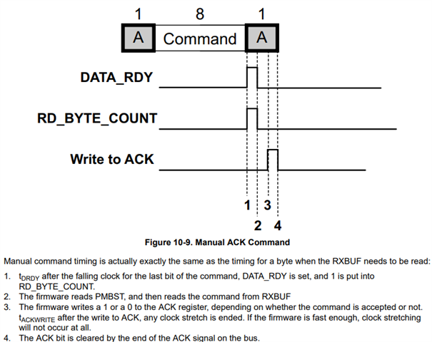

  • Hello Tina,
    Correction, it is possible to manually choose a NACK based on different I2C commands. You will need to set up a Manual Command ACK. See section 10.3.7 in the UCD31xx TRM on page 378.

  • Hi Tina,
    As shown in my previous post, this is possible. You can manually choose which commands the UCD3138064 will send an ACK or NACK to. Please see the TRM for more information.

    I think I didn't explain my problem clearly.
    Section 10.3.7 in the UCD31xx TRM is command solution, but my problem is address.

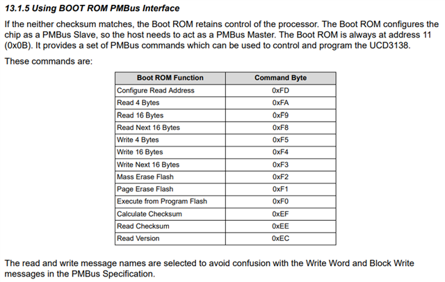

    Yes, 0x7F is a reserved command for the UCD3138. Are you saying that if you set PMBus ACK to manual mode, sending a 0x7F command will still return an ACK automatically? If you have not tried this yet, then I would try this first to confirm that the 0x7F commands responds an ACK in PMBus manual mode.
    If the 0x7F command responds an ACK in PMBus manual mode, then that may be a hardware limitation of the device. I can look into this to see if this is true. I do know that the UCD3138 has PMBus commands it will respond to in ROM mode. These will automatically send an ACK. A full list of PMBus commands supported by UCD3138 ROM mode are shown in section 13.1.5

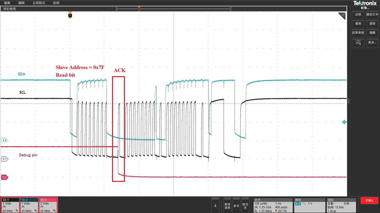

  • Hi Jonathan
    Thank you for your reply. But my problem is address.
    I try to set up a manual address acknowledge and I want address 0x7F respond NACK. FW set:
    Initialization PMBus:
                           PMBusRegs.PMBCTRL2.all = PMBCTRL2_HALF0_PEC_ENA
                                                             + pmbus_address
                                                             + PMBCTRL2_HALF0_SLAVE_ADDRESS_MASK_DISABLE
                                                            + PMBCTRL2_ALL_RX_BYTE_ACK_CNT
                                                            + PMBCTRL2_ALL_MAN_SLAVE_ACK;
     pmbus_idle_handler:
                            pmbst_shadow.all=PMBusRegs.PMBST.all;
                            if((pmbst_shadow.bit.SLAVE_ADDR_READY == 1) && (pmbst_shadow.bit.DATA_READY == 0))
                                    this_address = (PMBusRegs.PMBRXBUF.byte.BYTE0 & 0x7F);
                                    if(this_address == 0x58)
                                            PMBusRegs.PMBACK.bit.ACK=1;
                                    else
                                            PMBusRegs.PMBACK.bit.ACK=0;
                                            MiscAnalogRegs.GLBIOVAL.bit.SYNC_IO_VALUE = !MiscAnalogRegs.GLBIOVAL.bit.SYNC_IO_VALUE;      //Debug pin
                                    return ;
    Send address 0x7F, following this waveform, CH3 is transformation so FW respond NACK. But SDA/SCL respond ACK.
    Other address respond is correct. Address 0x77 respond NACK and 0x58 respond ACK that following FW setting.
    How can I do that send address 0x7F respond NACK?
  • Hi Tina,
    Thank you for sharing the code and the behavior based on the code. It looks like the 0x7F address will automatically respond with a NACK. I will look into this issue and get back to you by Friday. Our India team is on holiday for Diwali so I will need time to determine a work around.
