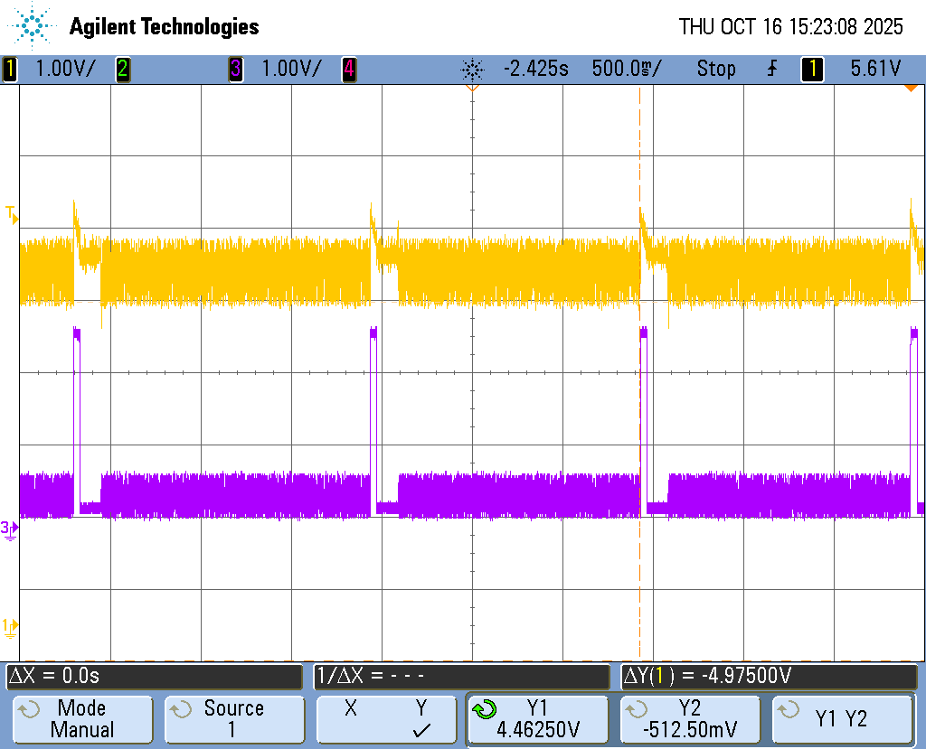

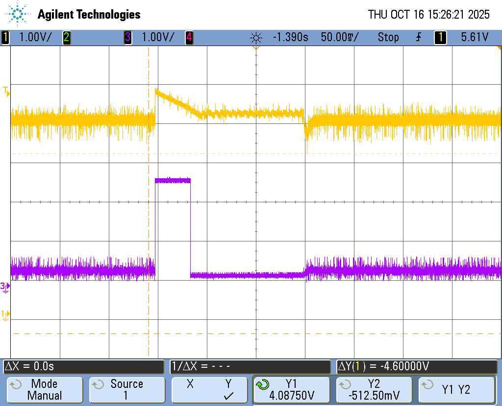

BQ25622E: PG toggles multiple times while charging and the batfet is in linear mode.
Part Number: BQ25622E
I am currently experiencing a problem charging our battery with the BATFET in linear mode when Vbatt < Vsysmin. It apears to attach and detatch the adapter multiple times before giving up and terminating charging completly. Vbus doesnt appear to be going below or above our set thresholds so It should see that it has a good adapter. Ive attached some scope captures of the Vbus(yellow) and PG(blue) for reference. Any ideas as to what could be causing this behavior? scope_29.pngscope_27.png
    Could you please provide more details?
    1. What are the charger operating conditions such as VBUS (voltage at VBUS pin), IVBUS, VBAT (voltage at BAT pin), IBAT, VSYS, ISYS.
    2. All the register readings.
    Ning
  • Hi Ning,
    I've attached the register readings along with a charge log showing that the battery charging fails once it exits pre-charge. I’ve noticed that this issue seems to disappear when the Vsysmin is increased from 3520 mV to 3680 mV—you can see this change near the end of the charge log, after several failed charge attempts.
    Regarding the charger operating conditions, there didn’t appear to be anything unusual with VBUS or VBAT, but I’ll take a closer look at those and the rest of the conditions to confirm.
    Finally, another thing I've noticed is that when it fails, it ends up in HIZ mode but I wasn't seeing anything in the datasheet that specified what could be triggering that.
    Registers and Charge Log:
