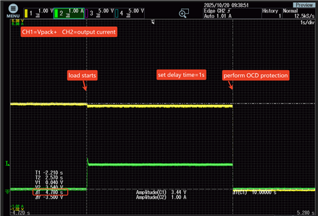

In sleep mode,give a load which can triger OCD,eg 1A.
What are the specific time components that collectively constitute the actual maximum delay time? Is it the same for current or voltage protection cause there're different update intervals in sleep mode?
For reference,in normal mode,i've ever tested ocd delay time=3s;from sleep mode,tested max. ocd delay=5s;change set-delay-value to 5s,then max.ocd delay from sleep=9s.

  • The gauge should not be in sleep mode if the current is 1A. I assume that you configured the gauge to exit sleep mode for a current that high. See the table in 7.3.1 for exit from sleep conditions. A current that high will typically trigger the wake comparator so this will wake up the gauge immediately and it will start measuring current and run its algorithm once a second. The delay times are relative to the gauge's 1 second cycle timing so the protection delay may be up to 1 second later than expected (if the threshold was exceeded right after the previous measurement was taken).

  • There's a wake comparator that will pull it out of sleep faster than the measurement interval. It doesn't take 4 seconds for the gauge to update current.
    FW protection runs on a 1 second cycle so once the gauge is out of sleep and measures current (after 1 second) then the gauge will run the protection code and it will apply all rules for each firmware controlled protection event.
  • Thanks for your reply.Though the waveform shows a different condition.

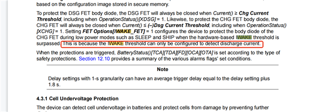

    May I ask if you are referring to the Hardware i-wake?This indeed helps understand the delayed discharge current protection, but are there other immediate wake-up parameter settings for charging current protection /voltage protection and temperature protection? Thank you
  • The gauge needs to wake up for FW protections to work because those require active measurements every second.
    There aren't any other settings to wake the gauge up. Note that the HW protections (supercomp) still work, regardless of sleep or normal mode.
