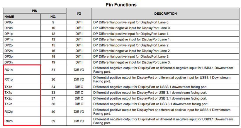

Hi expert,
Want to confirm if TUSB546A support P/N swap? Thank you.
Randy
Hi expert,
Randy
Hi Randy,
The TUSB546A does not support polarity swap.
The routing in the TUSB546A will be positive differential input and negative differential input to positive differential output and negative differential output respectively.
