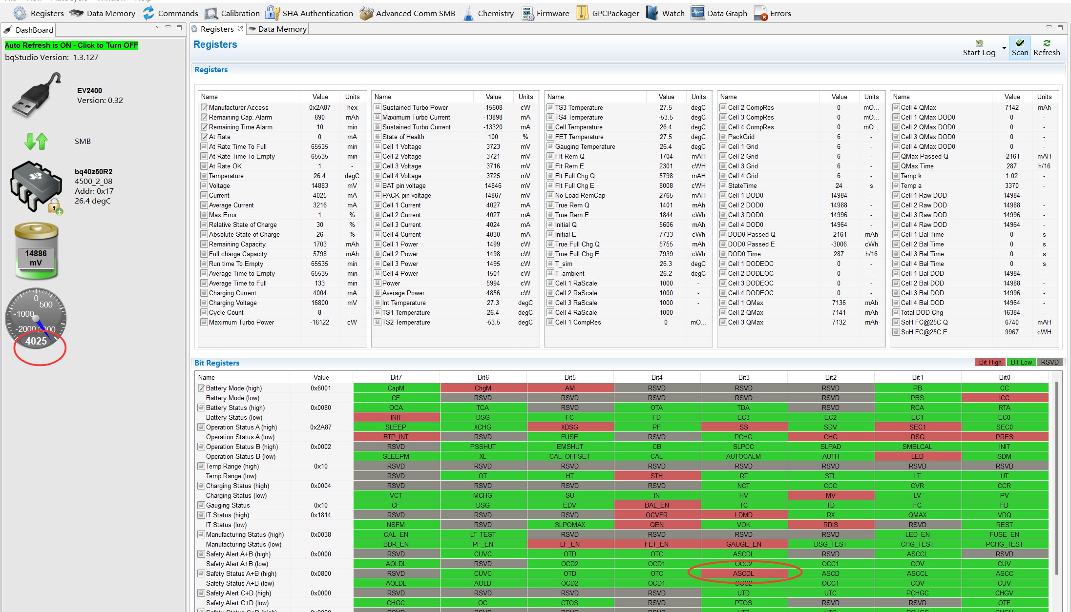

BQ40Z50-R2: BQ40Z50 cannot recover after short-circuit protection
Part Number: BQ40Z50-R2
Dear FAE, hello,
    I have designed a battery protection board using BQ40Z50-R2. After conducting a short circuit test on the finished product, the ASCDL raises a flag, but it does not automatically recover. The battery cannot be discharged, and even if the battery is charged, the ASCDL cannot be eliminated. However, charging is normal. The attachment is a GG file. Could you please help me identify where the configuration is problematic?
Thank you!
