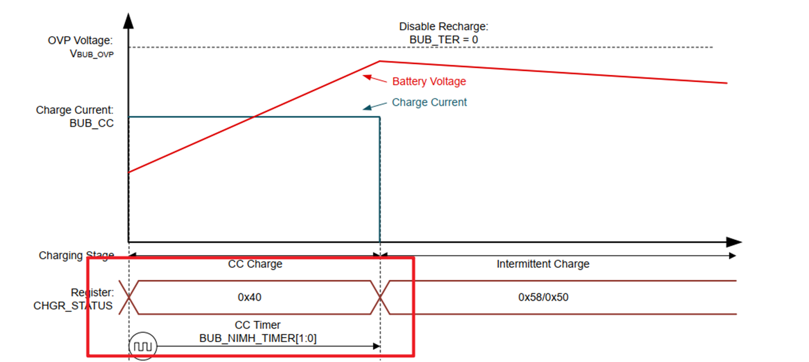

Q1: The changing end condition is Battery voltage archived target voltage 2.68V(2*Ni-MH cell) or BUB_NIMH_TIMER[1:0] timer archived?
I have tested my development board.
If Battery voltage is >=2.68V when start charging, 61381 will report changing completed.
If Battery voltage is 2.67V when start charging, 61381 will continue change for BUB_NIMH_TIMER[1:0] time event the Battery voltage exceed 2.68V.
That means different start voltage will have same charging time and will get different end voltage, Is that a right behavior for 61381?
And do we need set different charge timer when we have different Battery voltage when 61381 start changing?
    Yes, this is the correct logic. The IC detects 1.34V x cell number before starting charging. After started charging, there will be only OVP threshold (1.7V x cell) and timer that can stop charging. NiMH battery nominal voltage can be around 1.5V per cell. 1.34V is only the initial judgement that determines whether the battery is empty or not.
    No, the OVP threshold (1.7V x cell)  is still there so there's no need for changing timer.
