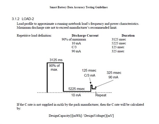

I test my battery pack with the load which is descripted in uploaded file to check the smart data accuracy..The battery RSOC jump from 10% to 0%..
I uploaded the related .log and .gg files , Please help to check...
