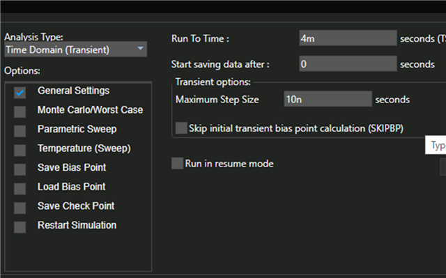

  • Hi Ryusuke,
    I thought you may stop the simulation too quickly after 1.8V Vout is reached. I had same problem that the Vout is always 1.8V no matter how the Vo1 and Vo2 is set.
    Well, after Vout gets to 1.8V, if just wait for 2ms more simulation time, the correct 3.3V Vout will be reached (I tried Vo1 = Vo2 = 3.3V on my side).
    Here are my parameter set and simulation waveform for your reference.
    Lei

  • Hi Lei,
    I changed the parameter and changed the run time to 4 ms and reflected the simulation result up to 3 ms, but the result did not change.
    Is the change method wrong? Regarding the change method, could you tell me which status was changed and from where?
    Also, even though I changed it in the Lib file, the VOUT remained at 1.8 V.
    I would appreciate your opinion.
    Ryusuke
