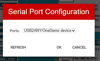

  • Hi Mallika,
    Glad the update was able to work.
    The GUI should automatically recognize the device when plugged in,
    Can you go to Options > Serial Port and check if there are any inputs being detected?
    There should be a 'USB2ANY/ OneDemo device' option being recognized at the port.
    Also make sure the USB2ANY explorer is closed/ there are not multiple tabs of the GUI open at once.
    Sarah
  • I can see the USB2ANY has been detected but failing to connect.
    The Port has been detected as specified.

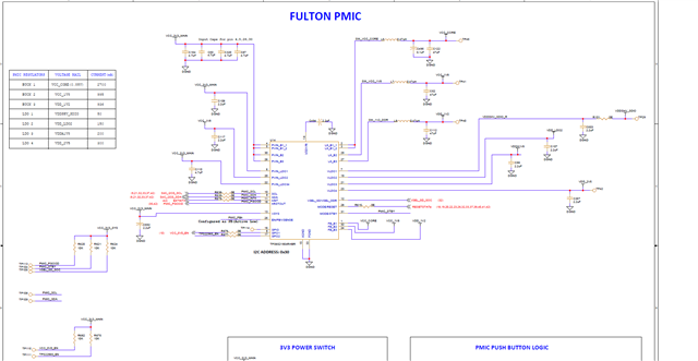

    Those connections appear to be correct, I just have a few clarifying questions:
    Did you replace the TPS6521401 PMIC that comes on the EVM with the TPS6521904 PMIC, as shown in the schematic?
    • TPS6521904 configured for push-button by default, so push button on the EVM will need to be pressed to enable device to active state.
      The EVM is already configured to support PB, so no modifications need to be made, just be aware that the button needs to be pressed.

  • Hi Sarah,
    We designed a custom board using design files of SK-AM62B-P1 EVM. On custom board the PMIC has been damaged. we are now trying to use TPS6521EVM to configure the design board.as shown
    On first Attempt: Reprogrammed TPS65219EVM using NVM having TPS6521901 PMIC with NVM:
    after reading register values, i just changed below register value
    BUCK2_VOUT,9,0xA4
    somehow the board has been shorted.
    In Second attempt: replaced the PMIC with TPS6521904 and MSP430 and programmed or updated firmware as seen in previous discussion, but the USB has got damaged.
    For requested questionary:
    • Did you replace the TPS6521901 PMIC that comes on the EVM with the TPS6521904 PMIC, as shown in the schematic?
      No, I did not replace the PMIC, I have reprogrammed it through the TPS65219 GUI to match the configuration and voltage sequencing of the TPS6521904 (AM62x reference profile).
    • TPS6521904 configured for push-button by default, so push button on the EVM will need to be pressed to enable device to active state. The
      Understood. I am aware that the push-button (PB) must be pressed to enable the device to enter the active state. I have not modified the EVM hardware in this area.
    • Are you reprogramming/reconfiguring the device via I²C in any manner?
      Yes. I am reprogramming the PMIC registers via I²C using the TPS65219 GUI connected through the USB interface. The updated configuration aligns with the TPS6521904 power-up profile.
    • Are you connecting to I²C from the processor, or from the EVM?
      → The processor I²C lines are not yet connected.
    Now we bought new boards of TPS65219EVM which has same TPS6521901 PMIC.
    Can you suggest if I could reprogram the same way with desired outputs of TPS6521904 on TPS6521901 and connect them to the custom board.
