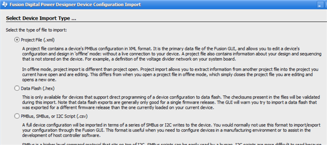

  • thanks for info I downlaoded the software and it is dated 2023. I then tried to open the fusion app and it can see the 3 devices I have but it gives a error message when I try to import the first device here are some images showing my steps and what I see.
    I can see the 3 devices I have
    I then click on the config supplies and done for this message
    I then see this screen

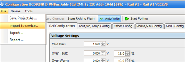

    so I clicked on the "click device config" button and then pointed it to the xml file we used in the previous version for the device on address 52d by using the import to device
    I selected the xml file
    I then pointed it to the xml file we used in the old version 2.10 I think it was
    I then checked all fields
    When I click on next I get this error
    I can't find that error message with a search so not sure what I need to do to fix this issue? Will I need to follow this same process for each device?

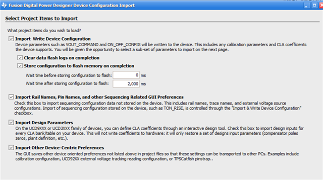

    Thanks for sharing all these screenshots, it definitely looks like our Fusion GUI is hitting a bug during the import. Let's attempt a couple things so we can try pinpointing which function is throwing that error:
    • Could you attempt importing one configuration file at a time?
    • When importing a configuration file, perhaps only try importing the NVM data, and if that works start adding actions to the import process until we run into the error again.

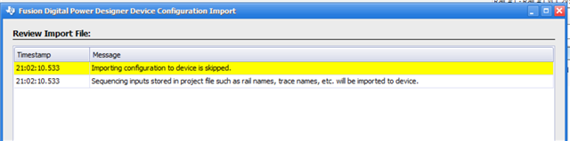

  • Just selecting Import write device gave me the same error message.
    I clicked on Import rail names and then got this message
    then went back to previous as I'm not sure if that will mess up anything
    I also tried Import design parameters and got this message
    again after this I clicked prev then tried import other device centric preferences and go this
    so it looks like the only one that cause the error is Import Write device configuration.
    What should I try next I canceled out of the import as I do not want to take a chance of putting the wrong config into the device

    Apologies for the delay and thanks for your patience. I got some time with our SME that owns development of Fusion and we discussed some things to try:
    1. Before importing further, please export the current configuration of your UCD devices using File-->Export and exporting the project file .xml
      Keep these handy in case of a bad import ever happens on your UCD9248.
    2. Just to confirm, using only "Import Write Device Configuration"  caused the same error you shared last week?
    3. Please send us all your exports of the UCD9248 configurations, as well as the intended configurations you are trying to load on
    4. Just to make sure we're all working on the same version of the software, I'll be sending an installer of the latest Fusion GUI branch to your email. Please download and install it, and then reattempt the import. Please let us know if the same issue occurs as well as it's help us diagnose the issue.

    yes I only get the error if I have the Import write device configuration checked if I uncheck this box it at least only gives me warnings and no errors. But I did not do the full import so not sure if it will work.
