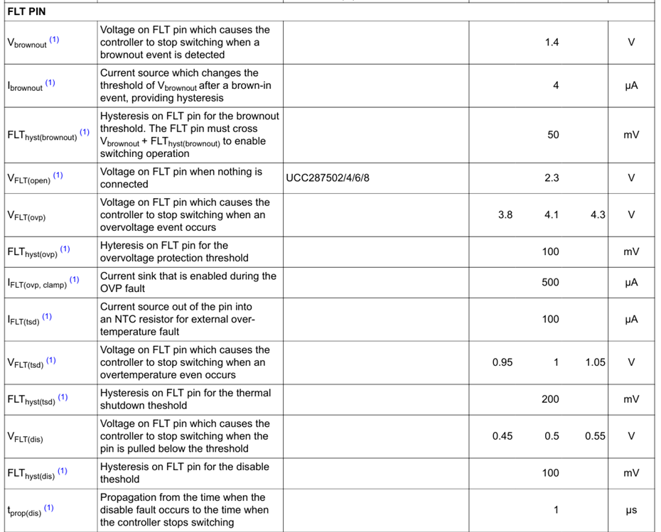

    To debug the issue, would you please measure the voltage on FLT pin when you apply 400V and 420VDC? I believe that provides an answer.
    Also, apply an external voltage through a resistor to find out which of the FLT pin thresholds are working and their behavior could tell us, if the part you were using is of a different variant instead of x2.
    Please see different thresholds (and functionalities) available on FLT pin based on device variant.

    Where there is no resistor divider at FLT pin and when the IC is functional, what is the voltage do you measure? Does it match with the EC-table?
    On how many devices, do you observe this behavior.
    For correct OVP and OTP circuit design with UCC287502, please follow the datasheet recommended circuit as below.

    When there is no resistor divider, FLT pin floats, its voltage measured 2.3V, matches EC table for the IC version.

    Let me try explain how the OVP circuit is expected to work here.
    As long as the output voltage is within limits, the zener doesn't breakdown and the voltage at the FLT pin depends only on the resistance connected to GND at FLT pin. The voltage at FLT gets superpositioned with the votage that is R(FLT-GND) x IFLT(tsd) ( 100uA).
    When there is an overvoltage, the zener diode should breakdown and conduct. The additional current through zener and series resistor flows through the resistor connected from FLT to GND. That increases the voltage on FLT pin to hit the OVP threshold and act.
    To reach a higher voltage on FLT, we need a smaller resistance in series, so that we have sufficient current available. Which wasn't possible with the 2Mohm you used.
    So, I recommend to modify and test the circuit as recommended.
