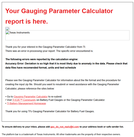

I am using GPC to get chemID for a 2.7V Li titanate battery.  The email never shows an error. I attached the GPC.zip file, and report, and an email screenshot. The GPC report is only a 0. What's the reason? Could you please help me?
Attached is the file.

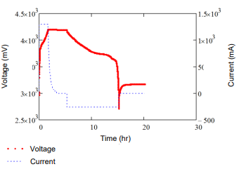

  • I follow the Simple Guide.And I have modified my file several times, but it has begun to exhibit errors. Please tell me what I can do for this.
    6746.roomtemp_rel_dis_rel.csv
  • I plotted a graph using the data, as shown below. We are charging 20Ah with a small current of 2A. Could you please tell me why GPC keeps showing errors? Does this mean we cannot use this chip in our case? I look forward to your prompt reply. Thank you.

    0
    Summary of all IDs with max. DOD deviation below 3%
    Chem ID	max DOD error, %	Max R deviation, ratio
    0	0	0
    Accuracy Error: Deviation is so high that it is most likely due to anomaly in the data. Please check that data files have recomended format, units and test schedule

    The issue is with the data you have submitted. Your log data shows that there is no relax after charge and discharge.
    Instead, your data should look like the following:
    Jonny.

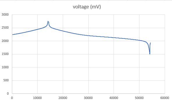

  • Good day.
    I replaced it with another set of test data from the same type of battery, and the result report still only shows “0”.
    I hope you can give me some practical advice.I would greatly appreciate it if you could reply as soon as possible.
     8053.roomtemp_rel_dis_rel.csv
    I believe I found the issue. I am not sure that our gauges will support this battery chemistry. These cells discharge to below 1500mV which is well below our minimum operating voltage. In other words, you will not be able to use these cells with our battery gauges.
    Jonny.
  • In our actual application, we cut off at 2V. I replaced the charge and discharge data to be based on 2V, but the same error still occurs, so I think there is no matching battery in the ID database and a custom ID is needed.
  • Hello Ying,
    Yes the data looks good, it is possible that we do not have a chemID that matches your cells.
    Jonny.
