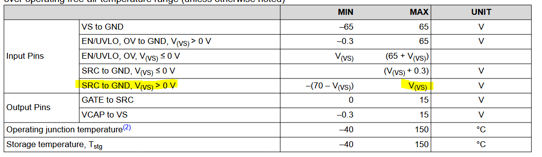

Hello TI Team,
my understanding from the datasheet is that SRC must never be higher than the current value of VS:
Using the recommended VS protection circuit as shown in the datasheet this cannot be guaranteed:
During startup or during an overvoltage event, VS will lag behind SRC, as simulated here:
In another thread in this forum it was stated that a violation of the SRC abs value is inevitable and causes no harm.
Can you please clarify whats the correct absolute value?
