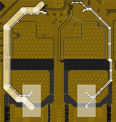

  • Our secondary sync FET and inductor are consistently the highest temperature devices in the circuit, regardless of relation to the input or load, ie. there is a slight difference in trace length from the outputs to the load, and since there are multiple instances of this circuit with different placement relative to the load connection, we can compare the circuit performance to understand if the different in trace length to the load is a cause. It doesn't seem to be. I hope this drawing this helps to explain what I mean... The secondary is on the right. The next circuit alternates, with the primary being a shorter connection to the load.

  • I have measured ~21.3mV on ISNS1+/BIAS1VOUT1 and ~26.3mV on ISNS2+/VOUT2. What changes should I make to make these equal? So far you've mentioned the change to a short body shunt, what about ISNS traces? The ISNS traces are on internal layers, but not on the immediately adjacent layer. Could that extra inductance be the culprit? I tried to replicate how those traces were placed in the EVM. The EVM has the shunt on the top layer, and the ISNS/VOUT traces on layer 5, I have shunt on bottom layer and ISNS/VOUT traces on layer 2.
  • Hi Stephen,
    Are those SW copper areas with vias? If so, that's likely the issue....noise coupled on to the CS lines. Check the differential voltage waveforms at the CS pins.
    Tim

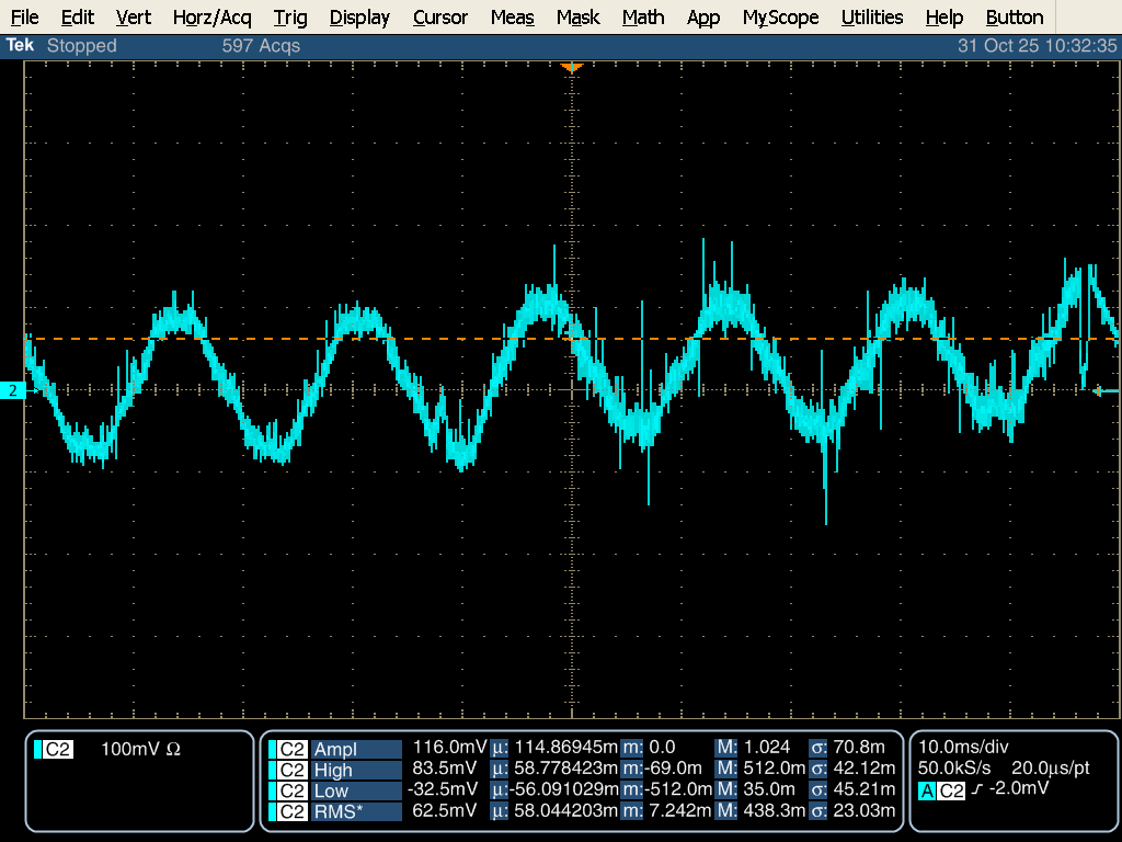

  • Is this the noise you are referring to? It is definitely noisier than the EVM, which is shown in the second capture.
  • Do you recommend removing or keeping the CS signals well away from the SW copper areas? I need to keep the SW thermal pad and vias to couple to the heatsink on the opposite side of the PCB.
    FWIW, the bottom copper areas between the inductor and shunt will likely be removed, which are likely the closest coupling signals into the CS traces. These were added to try to help to get inductor heat out to the heatsink, but they don't seem to be doing much as the inductor is really only coupling heat out via the pads.
    Can you please share what the max expected current imbalance there should be? I couldn't find this specified in the electrical specs.
    Also, is there any tuning of the filter cap that could help to clean this signal up?
  • Yes, keeping the CS traces away from SW is imperative. Also, SW shouldn't be used for heatsinking. Better to use VIN (drain of the high-side FET) for that. Refer to the EVM layout.
    Max current imbalance should be 10%.
