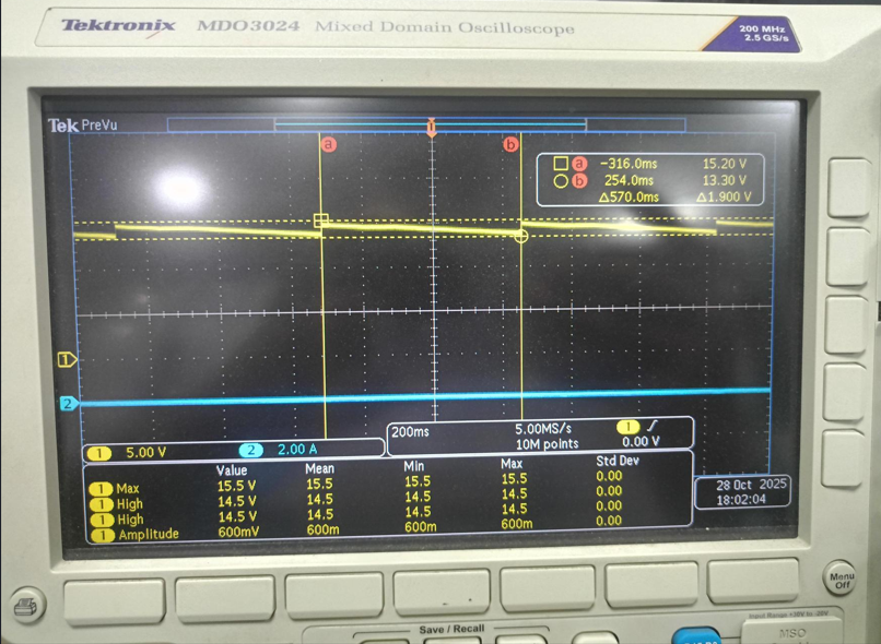

We are currently using the BQ25750RRVR battery charge controller IC to charge a 4S1P LiFePO4 battery (6000Ah capacity).
We’re encountering an issue where the charge completion status is not being properly indicated.
Observations:
Signals:
  • Yellow trace: Battery voltage
  • Blue trace: Battery current
  • STAT1 / STAT2 pins are toggling continuously.
  • Battery terminal voltage fluctuates between 13.3V and 15.2V in a repeating cycle.
  • Battery Open circuit volatge measured during this time is 13.7V.
  • EN_PFM is set to 0.
  • Charging current is set to 1.8A (0.3C)
We have previously discussed this issue related to the BQ25750 in the following thread:.
https://e2e.ti.com/support/power-management-group/power-management/f/power-management-forum/1552579/bq25750evm-the-charging-issue-with-the-bq25750
Note: We have BQ40Z50 Battery Pack Manager in our battery back.
Please help us solving this issue.
