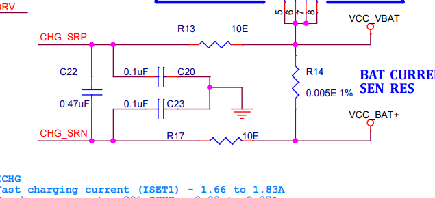

We designed a PCB using the BQ25750 charger IC (similar to the BQ25750EVM) to charge a 4S1P LiFePO₄ battery. The charging current is set to 1.8A, and the full charge voltage is 14.6V.
Issue:
  • The battery is not charging properly.
  • Charging current is very low (only 8–25 mA).
  • Output voltage at battery terminal 12.85V (same as battery voltage when the battery is connected).
  • Output voltage at battery terminal 7.05(when the battery is not connected).
  • No change in voltage or current even after 15 minutes.
  • STAT1 is ON, STAT2 is OFF (indicating charging in progress) when the battery is connected.
  • No changes made to default register settings.
Setup:
  • Battery voltage during testing: 12.85V
  • Input voltage (VIN): 12V
  • ICHG set as: 1.8A
  • ILIMIT set as: 10A
  • Actual load during this testing: < 0.5A
  • Buck boost Fsw: 250kHz
  • Driver: Internal LDO
  • CE pin: LOW (charger enabled)
Please help us identify and fix the issue.

  • Hi
    We implemented the following changes and now the current ripple reduced from 1.9A to 0.25A.
    Added an RC (1.8K and 0.1uF) parallel to ICHG resistor.
    However, when charging the battery using EVM (same resistor restting ICHG) the ripples is only 50mA, whereas in our charger design the ripple is around 0.25A.
    Could you please advise on what further modifications we can make to reduce the ripple to below 50 mA?
  • Hello Jeevabharathi,
    Did you place the BATSNS filtering caps as close as possible to the IC? Can you confirm you followed to PCB layout guidlines to run the sense lines a differential pairs?
    Christian
  • Hi
    In our current board revision, the charger sense lines are not routed as differential pairs. Given this limitation, is there any way we can further reduce the current ripple?
    Additionally, we've observed a difference in behavior between our design and the EVM. On the EVM, the STAT pin transitions correctly from "charging" to "charge done" at the end of the charging cycle.
    However, in our board, the STAT pin switches from "charging in progress" to "charging fault detected", and the "charge done" status is never reached, even after leaving the system running for several hours.
    Could you help us understand why this might be happening and suggest any possible solutions?
    Jeevabharathi
    Can send me a picture of the battery current sense lines so I can see what this looks like?
    Can you take an oscilloscope image of VBAT? This will help me see what's going on.
    I have a few suggestions to help the charger terminate:
    • Can you set EN_PFM=0?
    • Does increasing the termination current improve the behavior?
    • Does decreasing the charge current improve the behavior?
    Ethan Galloway

  • Hi Ethan,
    The charging process is now functioning correctly after setting EN_PFM = 0.
    The STAT pins are indicating a successful charge completion, and no charging faults have been observed.
    Thank you for your support! We are currently verifying the other functionalities of the battery charger and will reach out if we need any further clarification.
    Thank you.

    Also, we generally recommend setting EN_PFM=0 when the termination current is below 2A.
