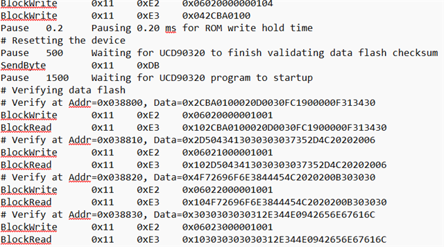

    We have few more doubts.Given below is the .txt file exported using fusion designer.
    1)
    After completing all write operations, the device needs to be reset. As per the .txt file, a delay of 500 seconds is mentioned for validating the data flash checksum, followed by an additional 1500 seconds for the UCD program to start up.
    Could you please confirm if we are required to wait for the entire duration specified? If we reduce these delays, would it have any impact on the upgrade process or device stability?
    2)
    Is it necessary to perform data flash verification steps after the device reset? If we choose to remove all verification steps, could this potentially lead to any issues or risks in terms of device functionality ?
    3)
    If data flash verification steps are required, we would need to reset the device again at the end of those steps. This would result in a total of two resets within the entire script. Could you please confirm if this is the expected behavior?
    In that case, would it be acceptable to remove the reset command after the BlockWrite operation and instead issue a soft reset command only at the end of the script? Kindly confirm if this approach is valid and would not impact the upgrade process.
    4) UCD90320: Remote upgrade of UCD via PMBUS script
    As per the query, we understand that the STORE_DEFAULT_ALL (0x11) command needs to be sent to make the configuration change permanent. Currently, this command is not being sent. Could this omission be causing the device to become corrupt?
    Given that the UCD90320 has a dual-bank configuration, our expectation is that even if the upgrade process fails, the device should revert to the previous version rather than becoming corrupt. Could you please confirm if this assumption is valid, or if there are additional steps we should consider?
  • HI
    Please see my response here
    1. it is ms instead of s unit. it is good to wait to ensure that it is completed
    2.no, that's fine to remove the verification steps. it shall not impact
    3. you only need one reset. the reset is to copy the data from flash to ram.
    4. no, you don't need since your script file is to write the flash directly.
    Yes, the dual bank shall prevent the corruption.

    1)
    In the .txt file,  BlockWrite operation is performed before the data at the address is verified. If we are removing the verification steps, would it also be acceptable to remove the corresponding BlockWrite operations?
    2)
    When writing to the data flash, we would like to understand whether the data is being written to the primary or secondary memory. Could you please clarify how this can be determined?
  • Hi
    1. it is good to remove both.
    2. the firmware determine which bank to write since it knows which bank is used internally.
    Yihe
