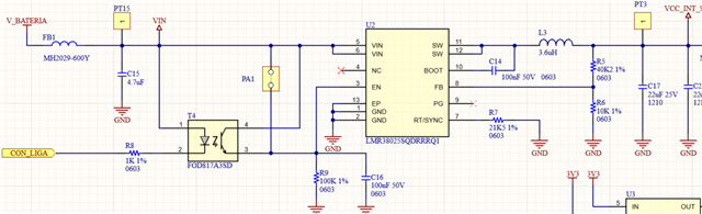

LMR38025-Q1: Enable input leakage current
Part Number: LMR38025-Q1
Hi
I need to design a circuit to control an LMR38025SQDRRRQ1 via the EN pin.
The best option would be a pull-up resistor and a transistor in the open-collector configuration.
Could you tell me the maximum resistor value for a voltage of 20V?
BR
Gilberto
