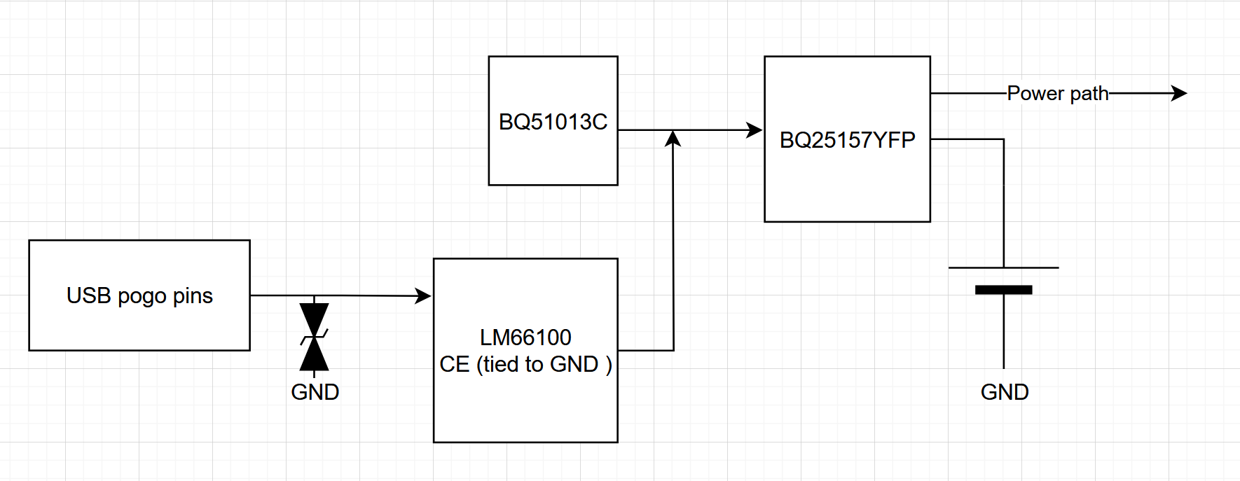

I'm developing a power management circuit for a wearable application.
The main features include battery management, low dropout from USB, inputs from USB (via pogo pins) and wireless charging, as well as reverse current protection for pogo pin swapping, ESD/surge protection, and a power path.
I'm planning to use the ESD761DPYR, LM66100, BQ25157, and BQ51013C, arranged as shown below.
I have some doubts:
  1. If both power sources are present, should the BQ51013 output be guaranteed to be higher than the ideal-diode output to avoid reverse current, and vice versa? Could reverse current flow into the BQ51013?
  2. If the pogo pins are swapped, will that force current into the BQ51013? An O-ring configuration might be a cleaner solution, but I want to avoid unnecessary components due to space constraints.
I’d really appreciate any feedback or suggestions you might have.
