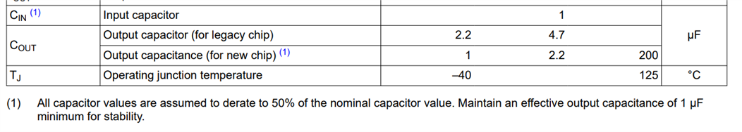

We have noted that the new datasheet specifies the following matching circuit requirements for the new chip:
  1. A 1uF capacitor for Vin, and a 2.2uF–4.7uF capacitor for Vout.
  2. The original design of the malfunctioning Main Control Board 1 was completed at least 5 years ago:
    • It uses a 100nF capacitor for Vin (smaller than the recommended 1uF).
    • It uses a 1uF capacitor for Vout (at the minimum of the recommended range).

    There's a 1uF effective capacitance requirement for stability for the new chip, a 1uF nominal capacitor will not always meet this. The datasheet notes 50% derating as a rule of thumb. Stability issues can show up only after a transient, at after which they lock themselves into an oscillating state.

    2. For Lot 2024 chips: Some have CCO origin "UK" (United Kingdom), others "USA" (United States), with different thicknesses of the silk screen font. Given the different origins, updated datasheet, and the distinction between "legacy chip" and "new chip" in the datasheet—do the required matching capacitor values for Vin and Vout differ between the two chip types?
    Yes. The new chip has an effective output capacitance and the legacy chip has an output capacitor requirement. There is also an ESR requirement in the new chip, but if you are using ceramic capacitors this should already be met. A 1uF nominal output capacitor is likely to guarantee that requirement is met over all operating conditions for the new chip.

    The 2023 version still mentions legacy and new chips but the 2016 version predates it, which would you like?
    2016  Note: No mention of Cout requirements in Recommended Operating Conditions Table
    2023
