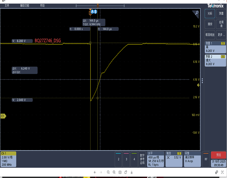

I have a product that uses the BQ27Z746 and encountered an issue during ESD testing. I performed contact ESD testing on the battery's GND with ±8kV. During the test, the battery was discharged at a current of 2A, but the DSG pin of the BQ27Z746 always experienced a momentary voltage drop, causing the product to have an instantaneous power loss during discharge. Please help confirm what I need to do to improve this issue, so that the BQ27Z746 does not momentarily disconnect the DSG (resulting in power loss) during ESD testing on GND. ThankS
