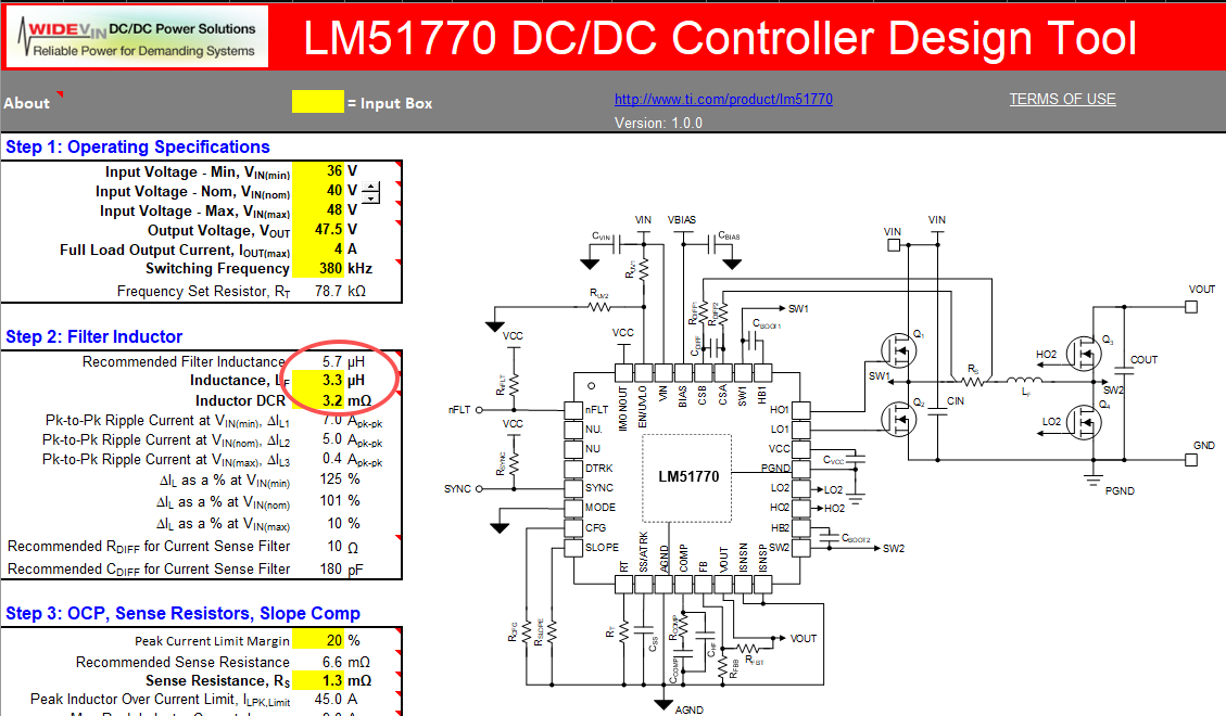

There are two questions:
1. Why is the inductance value of 22uH selected on the EVM? The calculation tool recommends a value below 5.7uH.
2. What modifications should I make if I want the EVM to output 60V/4A?
  • Hi Fan,
    the EVM was designed to also support higher output voltages.
    This are not supported by the EVM per default due to safety reasons with high voltage.
    So for higher voltage output you need to be some soldering and should ensure that you have the right environment and qualification for operating circuits above 50V.
    In this case just adjust the FB divider for 60V output. The EVM is able to support this from MSOFET and capacitor ratings.
     Stefan
