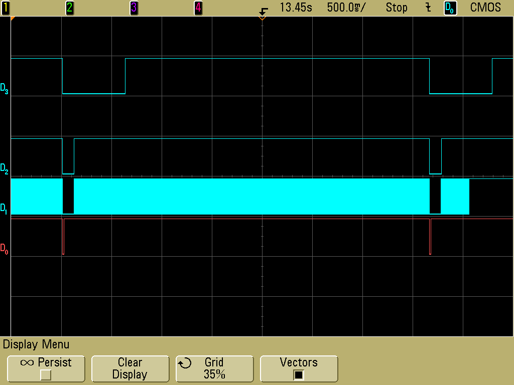

  • Hi Eric and thanks for the quick replay,
    Regarding the  VOUT_UV_FAULT response, i understood your explanation and i changed the "Max Re-Sequence" option to "unlimited"  (as you can see from my attached project file ) but still when i simulated it on my EVM the sequencer didn't preformed resequence of the rails as you can see in the attached oscilloscope screenshot (screenshot1).

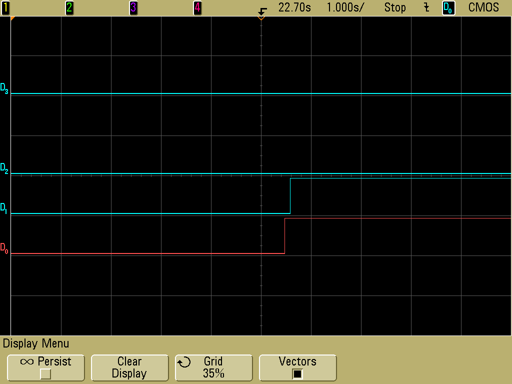

    I also attached screenshot (screenshot2) of the sequencer reaction to VOUT_OV_FAULT , and as you see the "failed rail" enable pin is being toggled while the next rails are enabled in spite of the fact i configured the sequencer to shut down all the rails when voltage fault is detected. (you also can see it from my attached project file ) .

    • In the screenshots D0,D1,D2 are Enable pins of the rails 2,3,4 ( rail 1 is the supply voltage of rails 2,3 and 4 ) and D3 is the system reset out.
    Screenshot1
    Screenshot2
    Slava.

  • After testing on the EVM, I also cannot get an unlimited resequence behavior for UV faults (only restart up to 1 time). Our docs only show max sequences up to 4 times but the GUI allows unlimited. I will have to check why that is there.
    For OV fault response, since the choice is retry continuously, the OV rail never shuts down and as such will not shut down the fault slaves. The OV faulting rail must shut down in order to take down the slave rails which excludes retry continuously.
