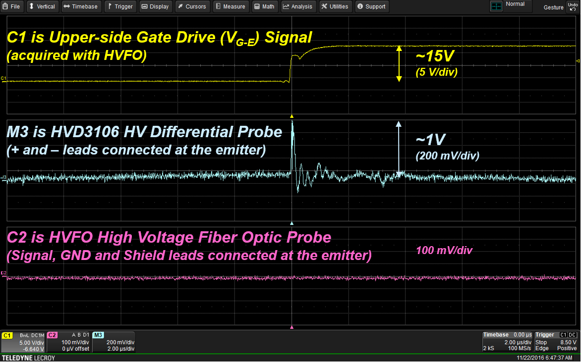

  • Hi Eric,
    After looking into these waveforms, I do not believe it is related to the capacitance C_GD. It seems most likely probe-related.
    For the positive half-cycle, the voltage spikes appear to be related the low-side switching. However, for the negative half-cycle, the voltage spikes appear to be related to the high-side switching. Based on the current loop, it seems most likely that this is an issue concerning common-mode rejection for the probe you are using. My best recommendation would be to use a better isolated probe, for example an optical isolated probe, if possible.
    You can test whether the voltage spikes are being introduced by the probe by connecting both leads of the probe to the HS ground (switch node), and if there is a voltage spike seen on the waveform, that would indicate the probe is the root cause for the spikes seen on the V_GS waveform. See the image below for an example:
    Will
