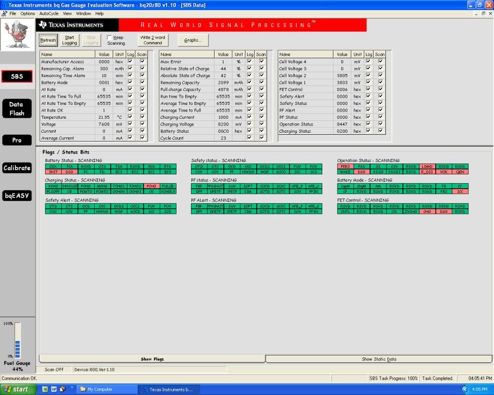

  • I understand the will turn off or on. The problem is both R_DIS and VOK are off.  How is that possible? QEN is on.
  • I understand they will turn off or on. The problem is both R_DIS and VOK are off.  How is that possible? QEN is on.
  • After 2 CHG/DSG cycles a pack was allowed to rest for 24h. It was then tested and was fine (test includes brief chg and dsg tests of less than 3sec ea and a SC test). The pack then rested for another five days and when retested R_DIS and VOK were set. (See inserted screen capture).
    Many of our production packs are tested this way (without the CHG/DSG cycles) and we don't see R_DIS becoming set.
    The pack was relaxing for 5 days, so according to JH's response above ("Once OCV reading is taken in relax mode, R_DIS is cleared.") R_DIS should have not been set.
    Questions:
    1. The pack was relaxing for 5 days, so according to response above ("Once OCV reading is taken in relax mode, R_DIS is cleared.") R_DIS should have not been set. Is that correct?
    2. That R_DIS became set does it indicate there are issues with this pack, or it is a matter of no concern and the pack can be considered good?
    3. Is there an easy way to validate/test for this?
    4. Are these flags not exclusive of each other, or what would set both simultaneously?
    Thank you!
  • Hi Alexander,
    Having the Rdis bit set during relaxation is not an anomaly and is not an indication of a problem. It simply means that resistance table update was disabled, this is temporary and once you have current flowing during discharge, as long as it is greater than c/10 you will have resistance updates.
    thanks
    Onyx
