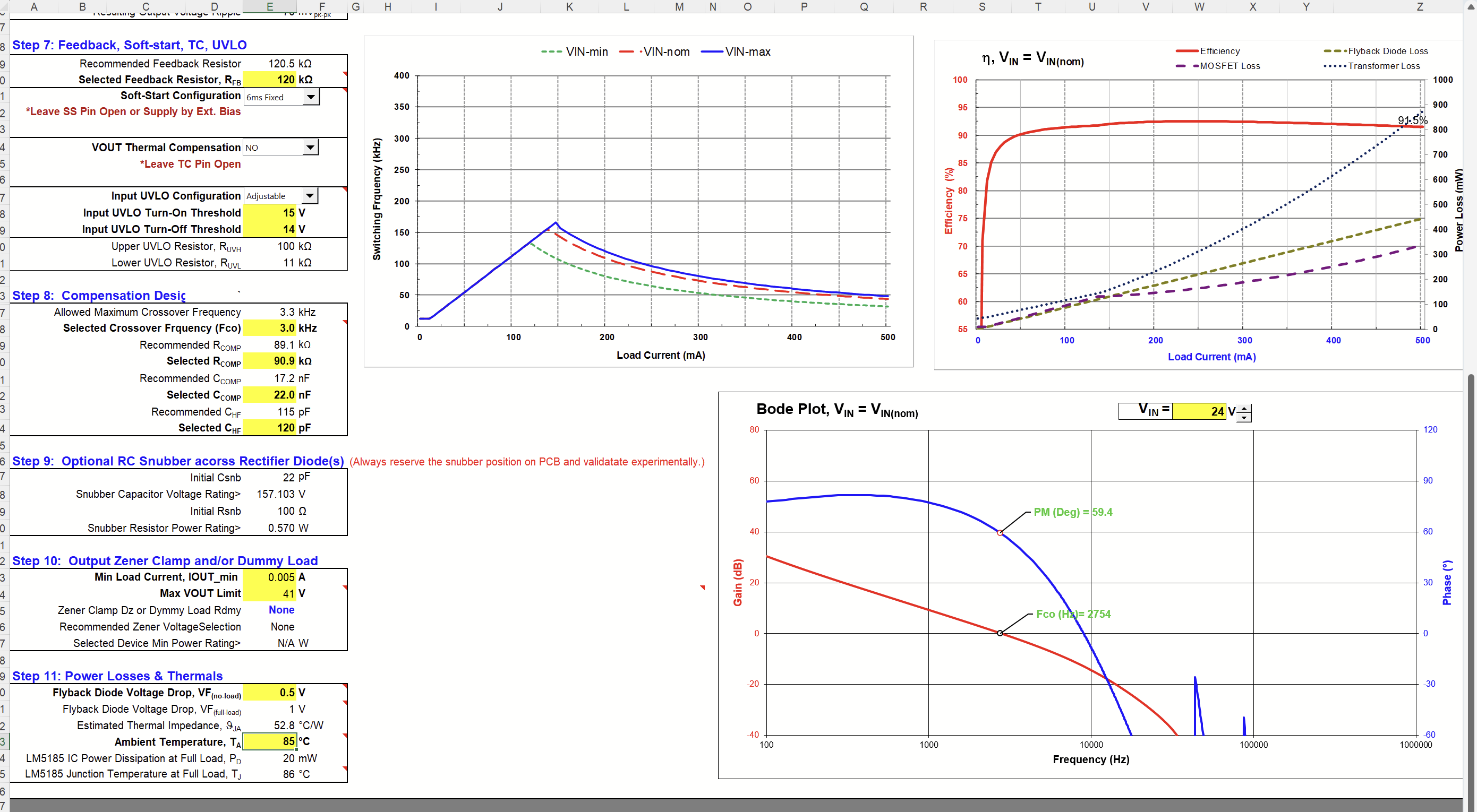

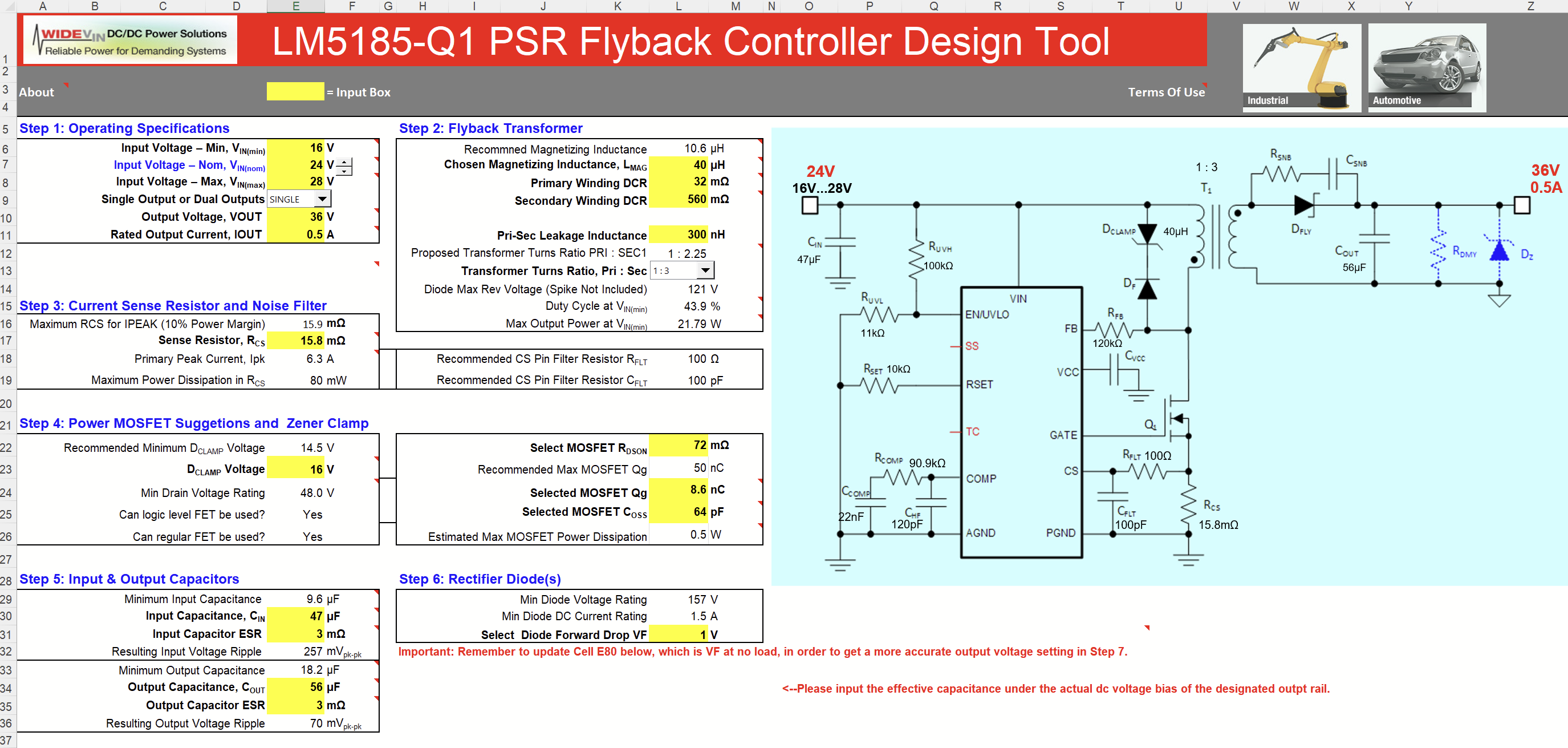

Here are screenshots from the LM5185 design calculator worksheet:

  • Hi Arttu,
    The device can function.
    But the device performance may not be optimal as it design to function in 3 operating modes based on output load and input voltage. Please check the operating frequency wrt to output load, it looks the Fsw remains below 100kHz for max operating period.
    Currently we don't have any test data with over sized transformer, our EVM transformers are designed for optimal performance.
    Thanks.
