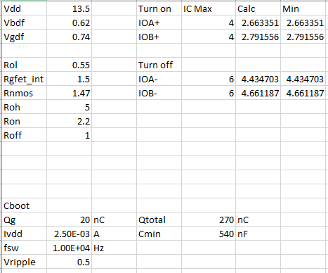

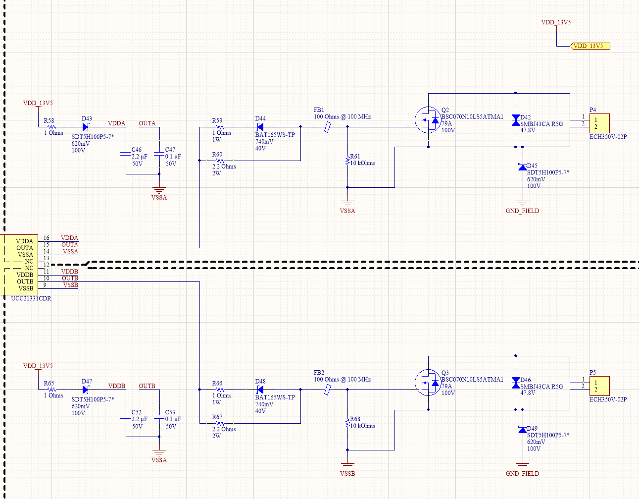

Am I missing anything for the below schematic?
  • High side switching brushed DC motor (diaphragm pump) - L = 10 mH, IPeak = 7A
  • PWM duty cycle between 1-10% @ 10 kHz
  • HV link voltage is 12V
  • Hi Robert,
    Are C47 and C53 capacitors supposed to be additional small decoupling capacitors for VDD - VSS? They are connected to the OUTA and OUTB nets so just want to confirm.
    Aside from that, there is nothing that sticks out as unusual here.
    I would highly recommend to utilize the schematic and layout design guidelines recently added to the product page under "Design & Development":
    This will have a complete checklist for all components that we recommend in a typical application.
    Hiroki
  • Should be in parallel with Cboot not between OUTA and VSSA, thanks.
    Yes, I followed the checklist and will follow the reference layout.
    One question I have is about Dclamp: Instead of placing steering diodes on OUTA/OUTB, is it OK to add a bidirectional TVS after the ferrite to protect the FET gate and UCC21331 output driver?  I cannot sink much power to the positive rail.
    Thank you
  • Hi Robert,
    I don't see an issue with using a bidirectional TVS to protect the FET gate as long as the voltage ratings are selected to fit the gate drive voltage.
    Unfortunately I cannot find any reference designs using this method as this is not too common.
