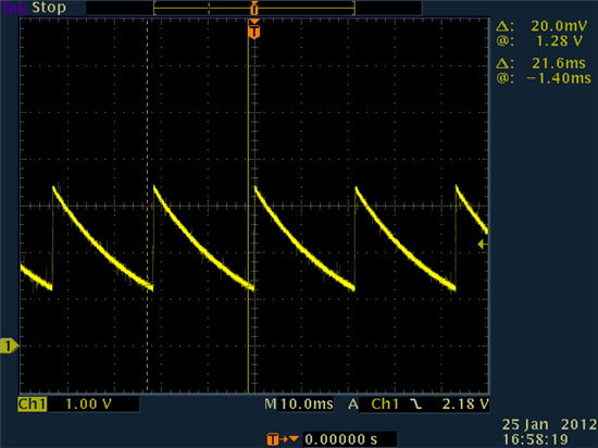

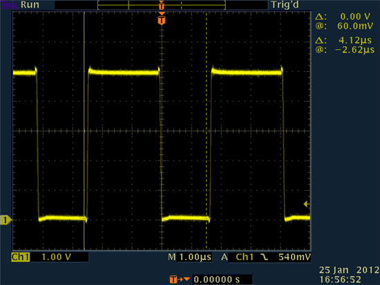

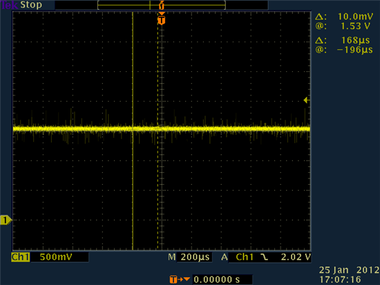

  • BAD channel:
    MOD :
    BAT pin:
    RC pin:

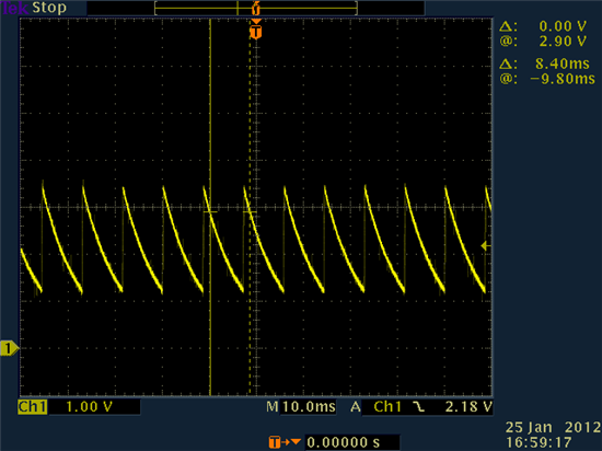

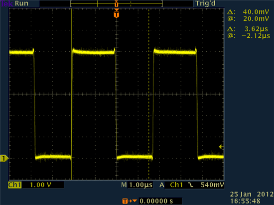

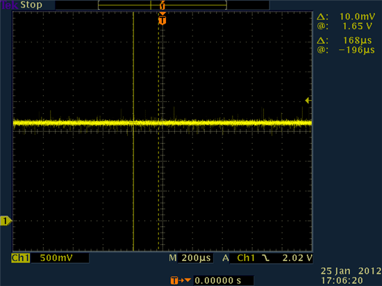

  • GOOD channel:
    MOD pin:
    BAT Pin:
    RC pin:

     Thank you for porviding these plots. I do not see anything obvious wrong  with the timers by just looking at the plots you provided, I need to do some measurement in the lab to our EVM to confirm that the timers is operating properly with your RC values.
