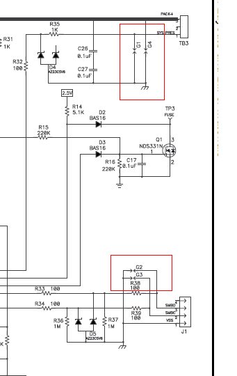

1. What does below marked(red) area, represent in z95 schematic:
2. While designing layout what should be recommended minimum distance two points: in SMBus connector, Cells connector (4P-1N)?
1. Those are spark gaps. They are used for extra ESD protection.
2. These rules should be specified by your layout tool. It should tell in the DRC when you have two points too close together. For devices, the minimum distance is usually determined by the package size, though. The devices shouldn't be overlapping or touching usually.
Chase,
How to implement spark gaps in layout. Any AN explaining this.
Deepak
The spark gaps are simply a component in the TI parts library. They are maintained by our library manager. I have attached the layout file for the z95, so if you download a PCAD layout viewer you should be able to measure the dimensions and make your own spark gap for your library.
