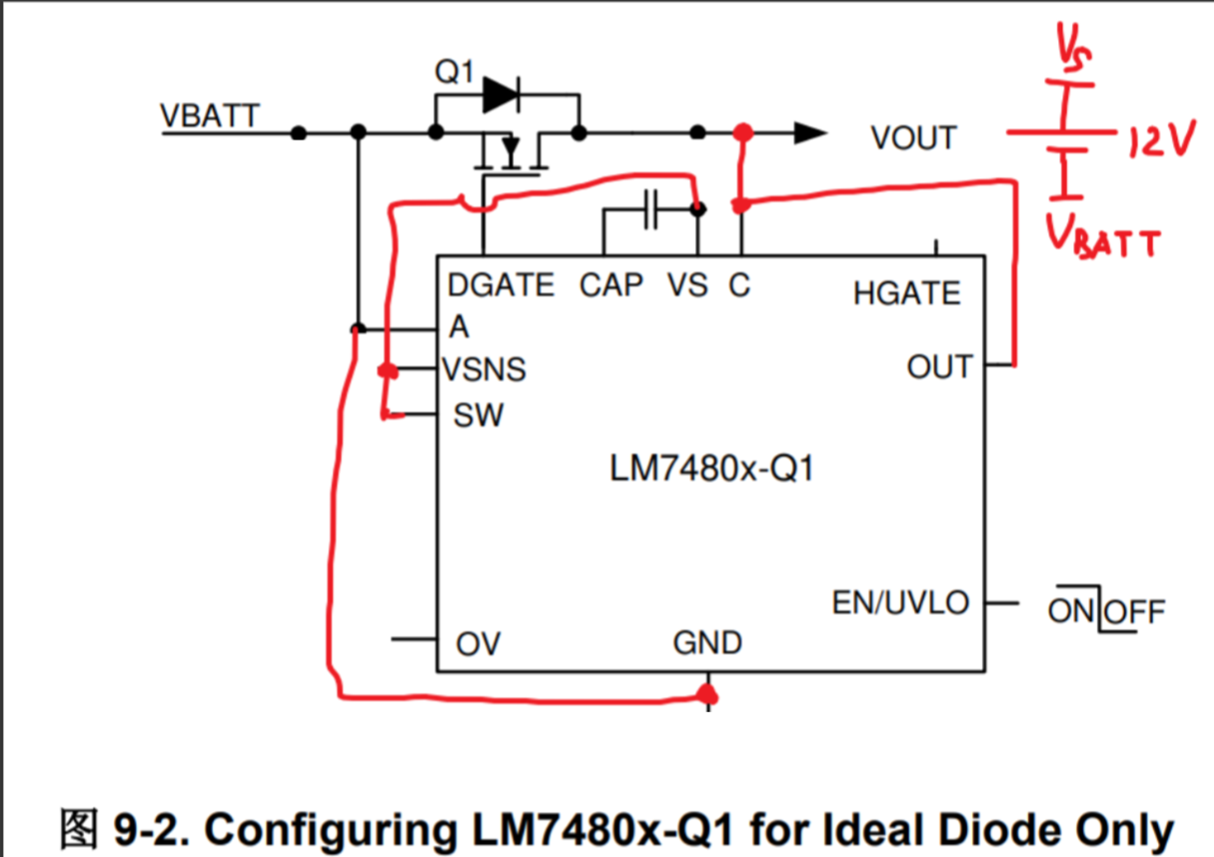

Customer used LM7480 and has a question as follows, could you please help take a look? Thanks.
"Is it possible to short-circuit the GND and A pin and supply an additional 12V to Vs as the power supply? Which is shown below."

  • Hello Francis,
    I have some questions:
    1. What is the application?
    2. 12V supply is connected between VS and VBAT. How will you get the output?
    3. LM7480 sense C and A voltages and if C voltage higher than A voltage then DGATE turns off.
    Mani.
