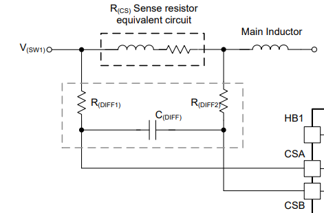

    The LM5177 datasheet specifies that it does need a RC compensation network for current limit operation:
    And I am looking to limit the current to roughly 400mA. Could you suggest some values for the RC compensation that would be suitable? Perhaps the ones you used for testing?
    In addition, the datasheet suggests a Rdiff / Cdiff filter for the peak current sense circuit with values around 10 Ohm and 180pF but never mentions the dimensioning for the ISNSP/ISNSN lines. However since the evaluation board includes 0ohm resistors and an option for a capacitor I assume that they should be placed here too. The evaluation board deviates from the suggested values by quite a bit though (100 Ohm and 100 pF)... It even suggests 100 nF for the cap in the ISNSP/ISNSN filter.
    Since the calculation Excel also does not mention the dimensioning, could you shed some light on how to find decent values, or share a set of good values for my 400mA setup? Or can I simply connect them to the sense resistor without this differential filter?

    The filter on the ISNSx lines is dependent on the layout and therefore are hard to define upfront. We recommend having the components there if needed, but if the layout is very good and the sense resistor is placed in the middle of the output capacitors it can work as well without this filter. The signal on the ISNSx pins is mostly DC, so the filter is just there for filtering noise due to layout.
