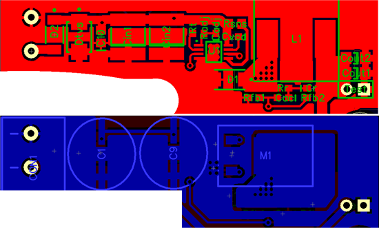

    And here is the pcb layout:
    I found an Excel spreadsheet at the LM25085 resources page, which seems to give different values to webench... although I notice its quite a bit older, so perhaps the webench vaues should be considered first?
    Anyhow.. if you see anything horrible with the pcb layout, that would be a great help to hear your advice.
    Thank you for your help, Michael.

  • Small improvement...
    I moved D1 to the back of the PCB (same position, as fortunately there was space directly under it on the bottom side of pcb)
    Added 10nF at C9
    Isolated (cut around) the 6 vias on the bottom side of the pcb (which are connecting the LM25085 powerpad to the bottom of the pcb)- to ensure the D1 gnd does not pass directly into the powerpad.
    Now the vout is stable until ~15.5 vin. So a vin improvement of ~3.5 volts
    This might suggest the problem is with the pcb layout (ie. noise) ?? Within the current layout, are there another other modifications which might be made to test for improvement?
  • Bigger improvement...
    Added (between C1 and C9):
    10uf 50v ceramic (same as Cin)
    470pf ceramic
    Now the vout seems stable through the vin range 5 - 31vin
    vout is 4.25 @ 5vin, rising to 4.45vout @ 31vin
    load attached is 2R2, drawing 1.88 amps according to series multimeter.
    However, I have made a fair few changes to the initial design, and would like to be certain which is/are the most likely factor?
    I read that the D1/Cin/Cout loop should be small, and considering I moved D1 to the back of the pcb, thought that the additional 10uF on the back would help provide that condition. Or is that a red-herring! Did the 470pF solve the case!
    Perhaps adding 2x10uF on back would now be better? Or removing 1 from the front, so I have 1 back, 1 front. Should I now revert the Radj back to the initial 2k21? I have still not fitted the series 10R to the PGATE (lack of space), but if that is needed / recommended when a Rsns resistor is used then I can add in the next revision. Probably too many questions... but for any part your advice would be much appreciated.
    Thank you!

  • Could you be more specific? not sure what you mean by "marginality".
    The generic switcher guidelines pdf looks interesting, thank you for posting.
    Otherwise, I can report that I changed the Radj back to the original 2k21 and removed the extra caps from the back of the board, except the 470pF, so it seems the solution for this design was to move D1 to the back of the board, and add a 470pF cap between D1-gnd and vin. On the next layout I will adjust the position of the FB resistor network, as it seems that might have been the culprit.
    Thank you for your helpful comments.
    Michael.
  • yep,
    the layout exhibits many parasitic L (because vias, thin tracks, thermal relief, and so on...)
    these parasitic L are very dangerous and noisy in switching converters: best practice is to keep all the power components on the same plane, keep the compensation parts close to the IC and well "shielded" by GND copper; no thermal relief should be used, and so on...
    all these L times the current changes (dI/dt) caused by the switching, generate L x dI/dt undesired voltage spikes ==> high EMI problems, ringings, possibly ESD engagement (with failure and/or damages to the parts)
    for this purpose I asked you the 2 things:
    - change RADJ ==> since nothing changed in behavior it was a layout issue
    - apply RGATE ==> this will reduce the dI/dt of the above, reducing all the spikes as well
    The very little cap simply performs better than the 10uF at very high frequencies (the contents of the spikes) and, hopefully, seems to be enough to fix the problem...
    If I were you, I'll check the waveform on the swithcing node and see the spikes on it (you will need a fast DPO to properly observe them...)
    Vincenzo
