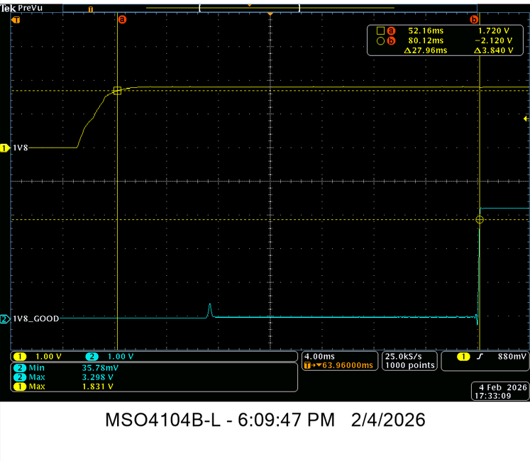

We are using TPS3808G18DBVR supervisor circut for 1.8V supply monitor in my application. we connected pins as mentioned below
VDD = connected to 3.3V and added 0.1uF decap
SENSE = conected to1.8V and 0.01 decap
GND = Board Ground
CT = open (NC)
#MR = open (NC)
Reset = connected to MCU with 10K pull up to 3.3V.

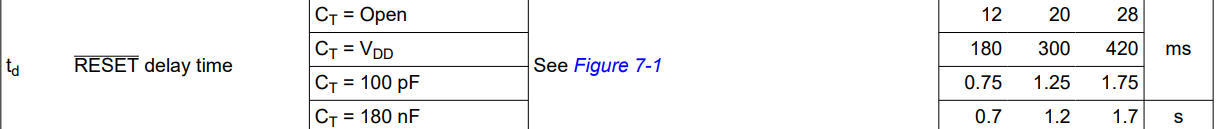

I am measured reset dealy time and it is crossing 28ms which is maximum reset delay time for CT = open condition.
I observed same behaviour in other board as well.
1.8V Reset Delay :

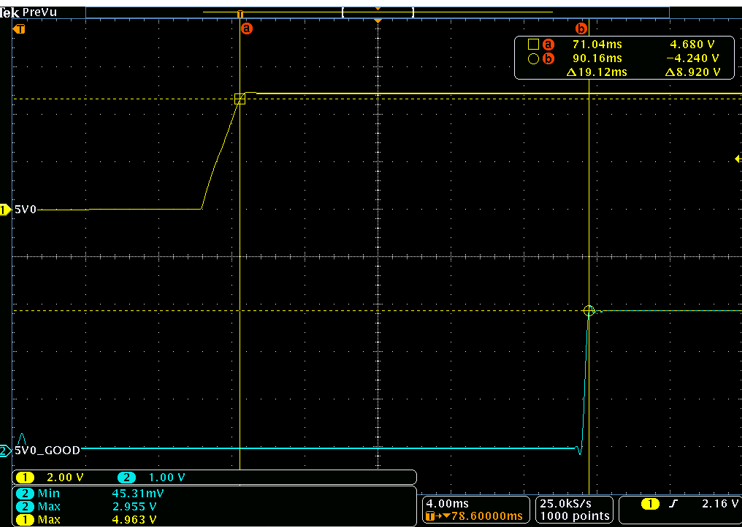

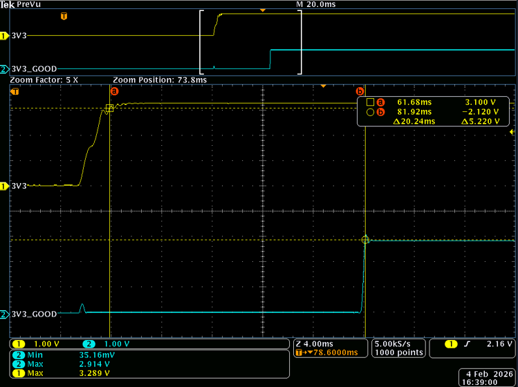

We are using same series fixed voltage supervisor ICs TPS3808G50DBVR, TPS3808G33DBVR with same connection as above expect for sense pin connected respective sense volatges 5V, 3.3V respectively and we are seeing reset delay times around 20ms for both the circuits.
5V reset delay:
3.3V reset delay :
Can you explain why for 1.8V IC TPS3808G18DBVR, we are seeing more reset dealy ?
