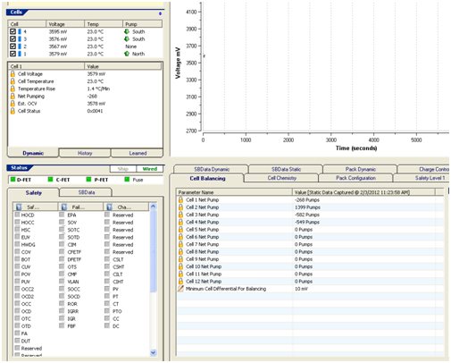

I have set 78PL116 with 4s_1P .tmap file & check cell balancing.
1. Set "Algorithm Enable = 000A" & "System Control = 0000". Now all cells should pump south.  But cells were randomly pumping, lowest cell was pumping north. As you can see in below screenshot, even Net pump shows negative value fr lowest cell :
2. Same way for cell pumping north settings, works same way. No change. Cells were pumping randomly.

  • Deepak,
    Here are some answers to your questions.
    1) You have Algorithm Enable set to = 000A, so Pump Mode (bit #2) is set to "Normal". Pump Mode must be set to "Testing" to force All Cells North or South. (see the PL 116 TRM page 60)

  • Tom,
    1. Algorithm Enable ="000A", so lower nibble is "1010", Pump mode bit is zero i.e at "testing", & Pump Algo[1:0] =10. ?

  • Deepak,
    1) You are correct, I misread my bits. :) The device should be pumping south with this setup. I tested it on my EVM and it is working. Are you using the TI EVM? Are you using FW Build 720 and Firmware version 6000.
