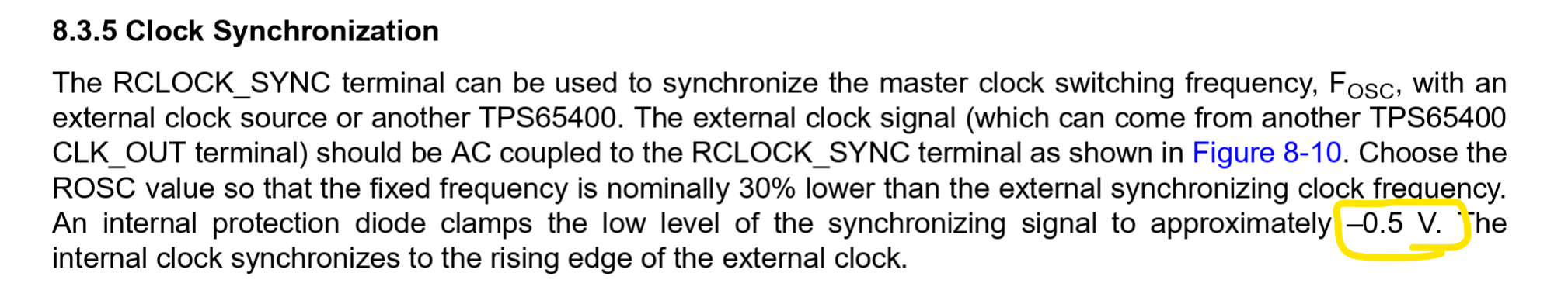

I have the following inquiry regarding the external clock of the TPS65400.

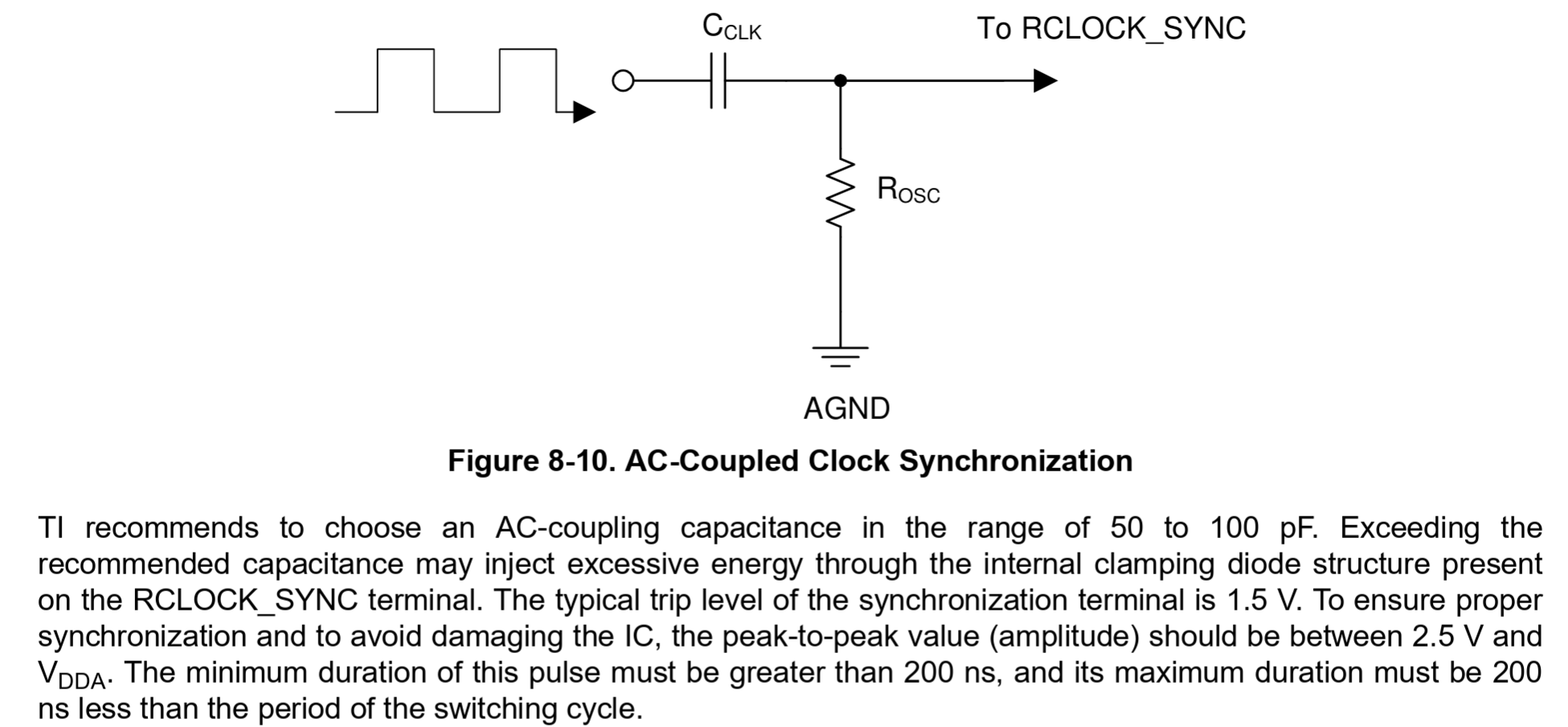

TI provides an AC coupling structure as shown in Figure 8-10 when operating the TPS65400 with an external clock.
The datasheet specifies that the absolute minimum value of the clock pin RCLOCK_SYNC is -0.3V.
However, Section 8.3.5 "Clock Synchronization" explains that the clock minimum value of RCLOCK_SYNC is -0.5V when using the AC coupling structure.
-0.5V is a value that exceeds the absolute minimum.
I would like to inquire whether an external Schottky diode or a buffer structure is required.
