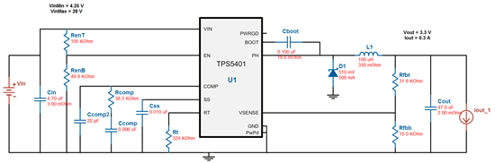

Attached schematic is for 5 to 3.3V buck 1.5A,
But this schematic output voltage is 1.7-2.0V.
Please help calculation for components.

SunSung,
The peak current of the MC33063A is 1.5A, so the output current must be less than 1.5A
TI has other buck regulator with a higher peak current rating.

SunSung,
While looking at your values, I noticed a serious problem. Not in your values, but in the MC33063A drive circuit.
The MC33063A has a Darlington NPN output that can drop almost 2V in certain conditions.
Your input is 5V, possibly lower with tolerances. The output needs to be 3.3V. So the nominal difference is just 1.7V
You either need to use a buck regulator with a much lower voltage loss to get good efficiency and current drive or you can use a linear regulator and get up to 66% efficiency.
Sorry that I did not notice this sooner.
Ron Michallick
Sandeep,
The TPS62237 or TPS62007 are better solutions with fewer external components.
To use the MC34063 would require an external low loss switch..

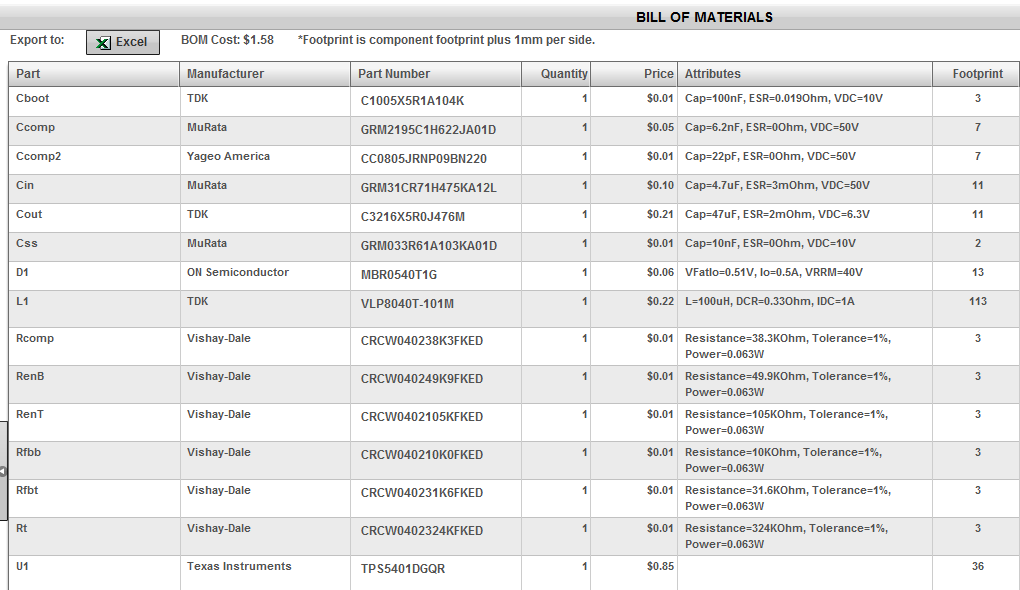

But my input voltage range is from 4.25V to 28V and output voltage is 3.3V. So what is the suggestion?
