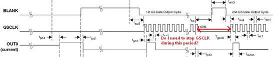

  • As per fig 6, after 4096 GSCLK cycles, this signal stops toggling and then BLANK goes HIGH. Does it mean that GSCLK should not toggle after 4096 CLK cycles and when BLANK is high? As GSCLK is given externally, such requirement seems unlikely but I just wanted to clarify.

    Regarding GSCLK I need further clarification.
    1. As per my understanding, after 4096 GSCLK cycles, PWM stops and all the channels are OFF, even if BLANK is kept LOW continuously. And I need to give a small pulse on BLANK restart a PWM cycle. I will change PWM value every ~33ms and I am planning to use 20MHz for GSCLK and need not change PWM value every 4096 GSCLK cycles but still I will need to toggle BLANK signal. Am I correct? Or I do not need to give BLANK pulse until I do not want change PWM duty cycle in GS register?
    2. Now as I do not need to change PWM value every 4096 GSCLK cycles, should I stop GSCLK after 4096 GSCLK cycles and when BLANK pulse is given or can it be free running during this time? As shown in attached block diagram, I am planning to use 20MHz oscillator for GSCLK. I will use a timer in MCU to generate BLANK pulse every 4096 GSCLK cycles i.e. every 204.8us. The accuracy of this timer will affect generation of BLANK pulse but that is acceptable for my application. I am more concerned about the requirement of stopping GSCLK after 4096 cycles. Even if I use MCU to control the oscillator, there may be some additional cycles after 4096 GSCLKs based on timer accuracy. Is stopping GSCLK after 4096 cycles till BLANK is toggled necessary? What will happen if there are some extra clock cycles during the period shown below?

    Let me try to clarify your GSCLK questions:
      Answer: Yes, you are correct, after 4096 clocks, the outputs will automatically be turned off. This was wrong in my previous post. sorry. So you can use a fixed clock signal on GSCLK, but you have to toggle BLANK to restart a GS cycle.
      Answer: You can leave GSCLK free running, but you need to toggle BLANK regularly.

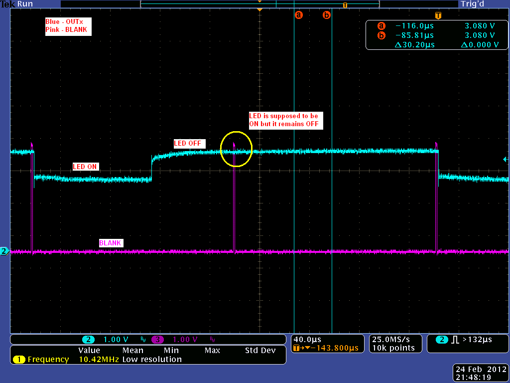

    I am testing TLC5945 and I am facing a peculiar issue where TLC5945 misses some BLANK pulses and LED is not switching ON after that BLANK pulse. Two test cases that I did are explained below
    CASE 1: GSCLK is 26MHz and it is free running i.e. GSCLK does not stop at anytime. BLANK pulse is generated after more than 4096 GSCLK cycles and LED is ON for ~65% duty cycle and as you can see from below picture, LED switches OFF as expected but it does not switch ON after first BLANK pulse but switches ON after next BLANK pulse.
    CASE2: I was thinking that GSCLK timing w.r.t. BLANK can be an issue. So, I gated GSCLK such that GSCLK is OFF during BLANK pulse. Sequence is GSCLK OFF  -->  ~1us delay  -->  BLANK pulse for ~1us  -->  1us delay --> GSCLK ON. But even in this case, same issue persists.
    What can be the reason for this behaviour in TLC5945?
    Vini

  • Hello Brigitte,
    This behaviour is not repetitive but random. Failure happens in both the cases above i.e. with continuous GSCLK as well as gated GSCLK.
    VCC and supply for LED are stable during failure condition. XERR goes Low when LED is switched ON but it becomes High again when LED is OFF or blank is high. This is expected as I have not connected LEDs at all output channels and XERR is going low showing LOD fault condition. Failure occurs with only one output channel ON @ 20mA and I think this should not cause TEF fault.
    I have captured waveforms for second case where GSCLK is gated. Below images should give more information. Images show
    1.  Failure condition
    2. GSCLK and BLANK timing
    3. Zoomed image when LED switches ON normally.
    4. Zoomed image for failure condition when LED remains OFF after BLANK pulse
    Vini
  • Hello Vini,
    The measurements and timing looks good. What happens when you replace the IC with a new one? When the failure is also there with a new unit, could you send me the total application?
