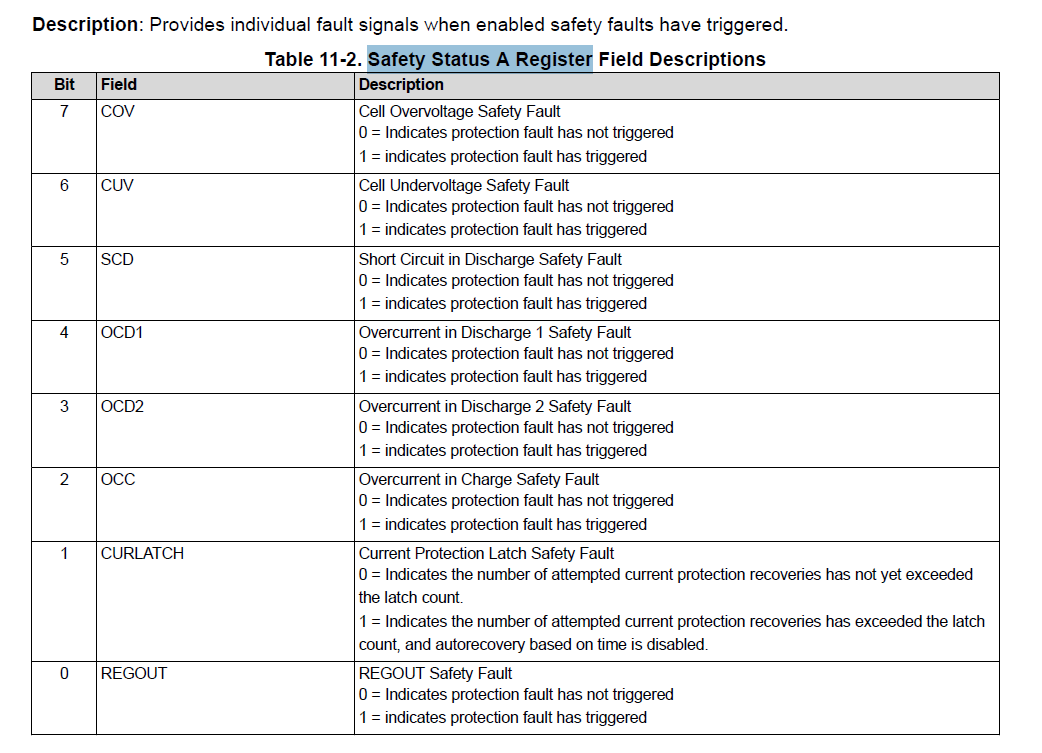

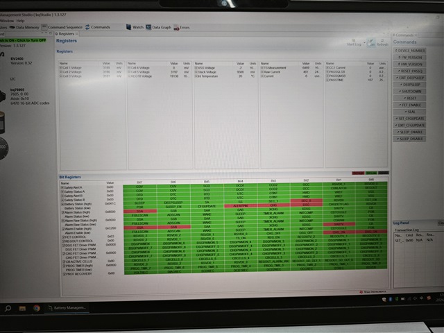

My customer used BQ76905 and they did not use REGOUT, so they hope to save the REGSRC resistor and capacitor, but find the alert will always be triggered,  and I found there is a REGOUT Alert in saftety status A regsiter, how to mask this alert?
