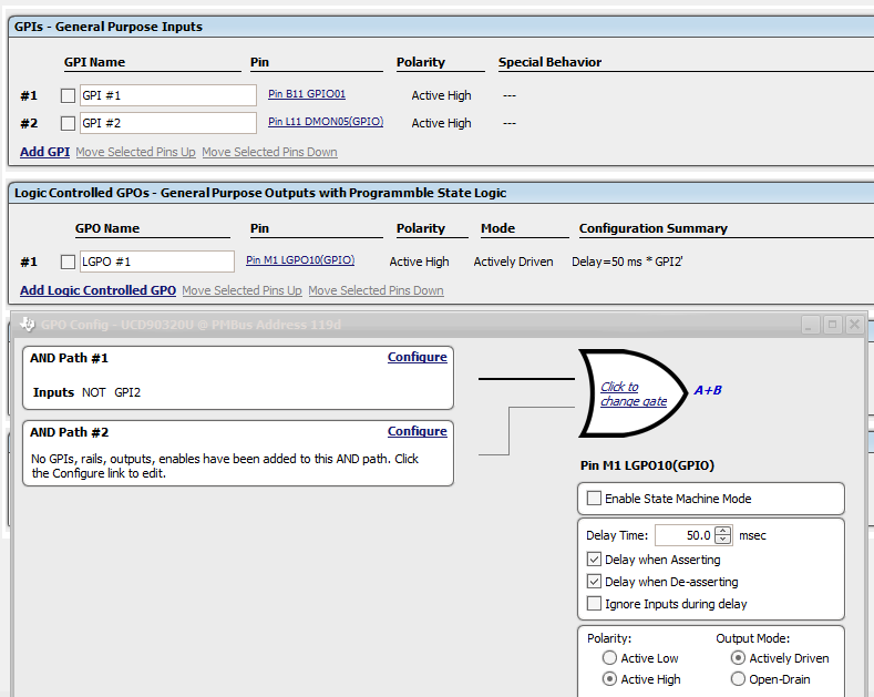

I configure LGPO #1 = NOT ( GPI #2) with a 50 ms delay.
  • Delay when asserted = ON
  • Delay when de-asserted = ON
  • Ignore Input during delay = OFF

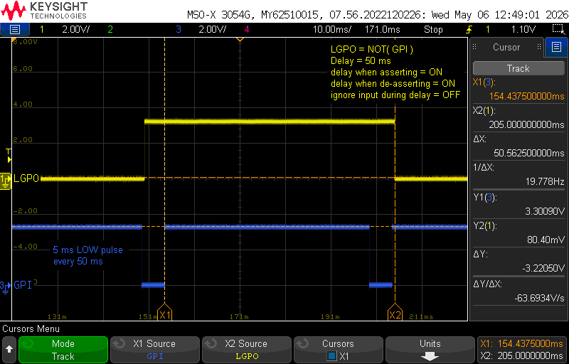

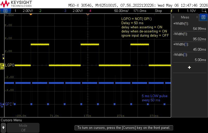

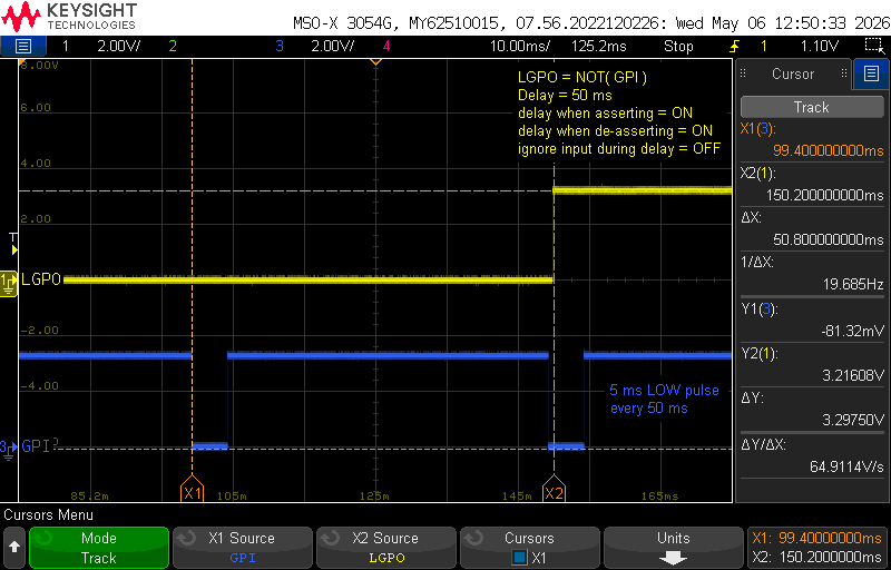

But I have tested it with the dev kit UCD90320UEVM and a LOW pulse on GPI during 5 ms every 50 ms.
Here is the result, the LGPO is toggling between HIGH and LOW every 50 ms.
It's not how it should behave.
In this conditions, LGPO should stay LOW.
Coud you please give an explanation ?
Here is the configuration screenshot :
Here are the measurement screeshots :

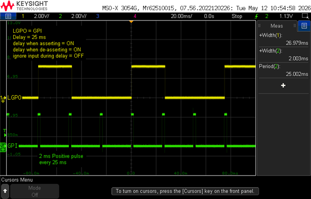

    LGPO = GPI with :
    - delay = 25 ms
    - delay when asserting = ON
    - delay when de-asserting = ON
    - ignore inputs during delay = OFF
    Issue is reproduced when GPI is :
    - positive pulse = 2 ms every 25 ms ==> LGPO toggling every 27 ms
    - negative pulse = 2 ms every 25 ms ==> LGPO toggling every 27 ms

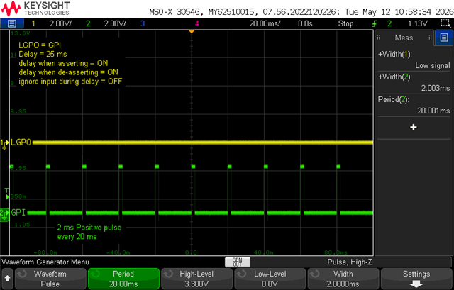

    Issue is not reproduced when GPI is :
    - positive pulse = 2 ms every 20 ms ==> LGPO = 0V
    - positive pulse = 2 ms every 30 ms ==> LGPO = 3.3V

  • Here are some screenshots.
    GPI positive pulse = 2 ms every 25 ms ==> LGPO toggling every 27 ms
    GPI positive pulse = 5 ms every 25 ms ==> LGPO toggling every 30 ms
    GPI positive pulse = 2 ms every 6.25 ms ==> LGPO toggling every 27 ms
    GPI positive pulse = 2 ms every 20 ms ==> LGPO = 0V
