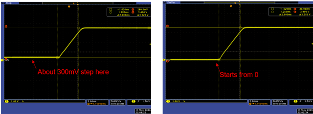

I am using LMR43620 for DCDC. I found that when I power up the 12V input , there will be a step on the output as I have shown. Could you please help to check with it? The yellow line is output 3.3V. image.png

  • Hi Frank,
    Thanks for your reply. I have a follow up question:
    I am now using it to drive LED driver board. With the LED driver, I can see the waveform has a step of 300mV on some of the boards. Do you have any idea about this? The waveforms are attached. They are from 2 different boards with the same layout and test function.
    Jane
  • Hello
    It is hard to say.
    Maybe some residual voltage from the LED driver.
