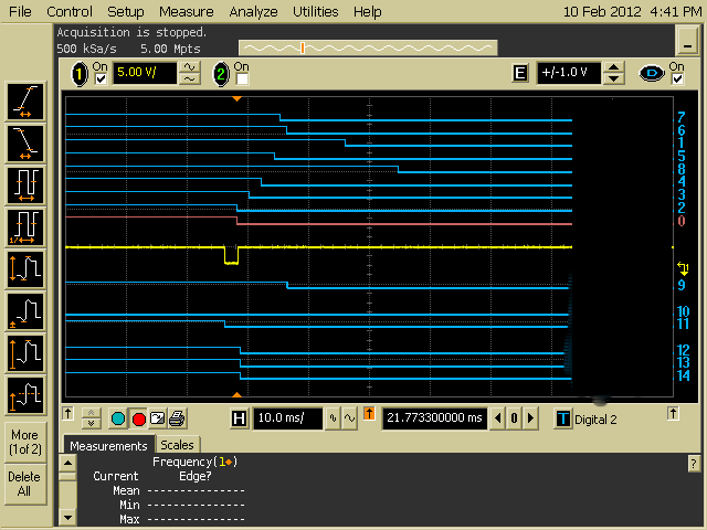

I use the UCD90124A with firmware version 2.4.0.0.

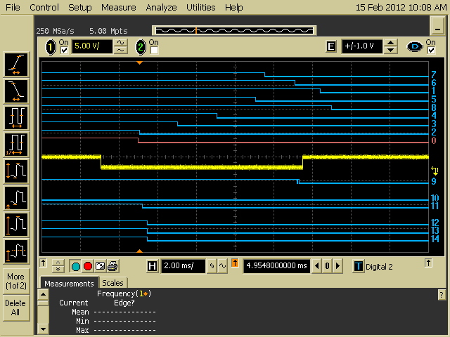

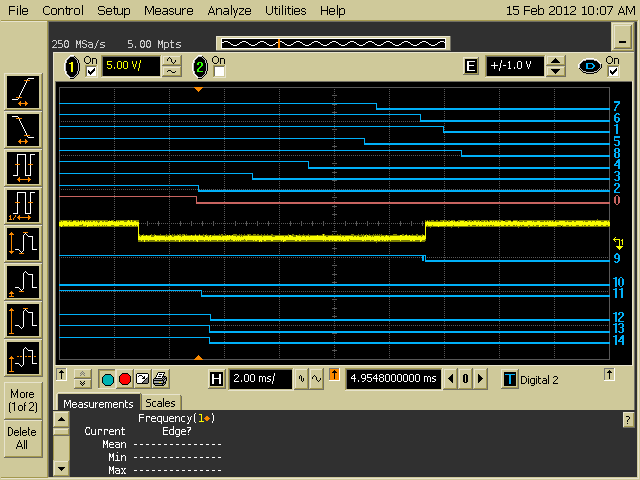

When one rail fails for longer time, the UCD90124A will shut-down all other rails well and restart after a short period.

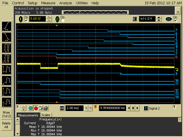

When the rail fails shortly (power is back before shutting down the first power rail), the UCD90124A shut down all rails but don't restart. (see attachment)
